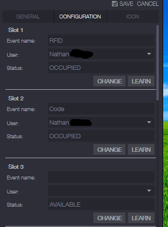

1: first add your users to the system in the user section.
2: now go to device manager of the keypad and choose a slot for each user, there are 10. So 10 individual users can be added, each with their own fob (ignore comment above from Nathan) :-)

Now you need to configure each user, by going into your alarm settings and choose users. Each user requires two lines, one for entry and one for exit. So these 2 lines have nothing to do with user spaces.

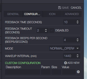

Can anyone help me out on how I can activiate the buzzer that the Mini Keypad is supposed to have ? When I enter my house in Armed state I do not hear a buzzing sound that I need to switch off the alarm. THe alam simply goes off without any warning. It is not clear for me how I configure the system that I am alerted with a sound. Same for leaving the house when I have put the alarm in Armed state: I would like to hear a sound so I can make sure I am leaving and locking the door so I do not trigger the alarm.
Anybody ?
Here is a screenshot of the configuration of my Mini Keypad;
Dear Ruud,
Yes, Mini keypad has a buzzer, which can be used as walk‐in/walk-out notification
(alarm is being disabled/activated). Our team is working to enable this feature. Please be patient I will give you an update through this topic when it is completed.
Pero
