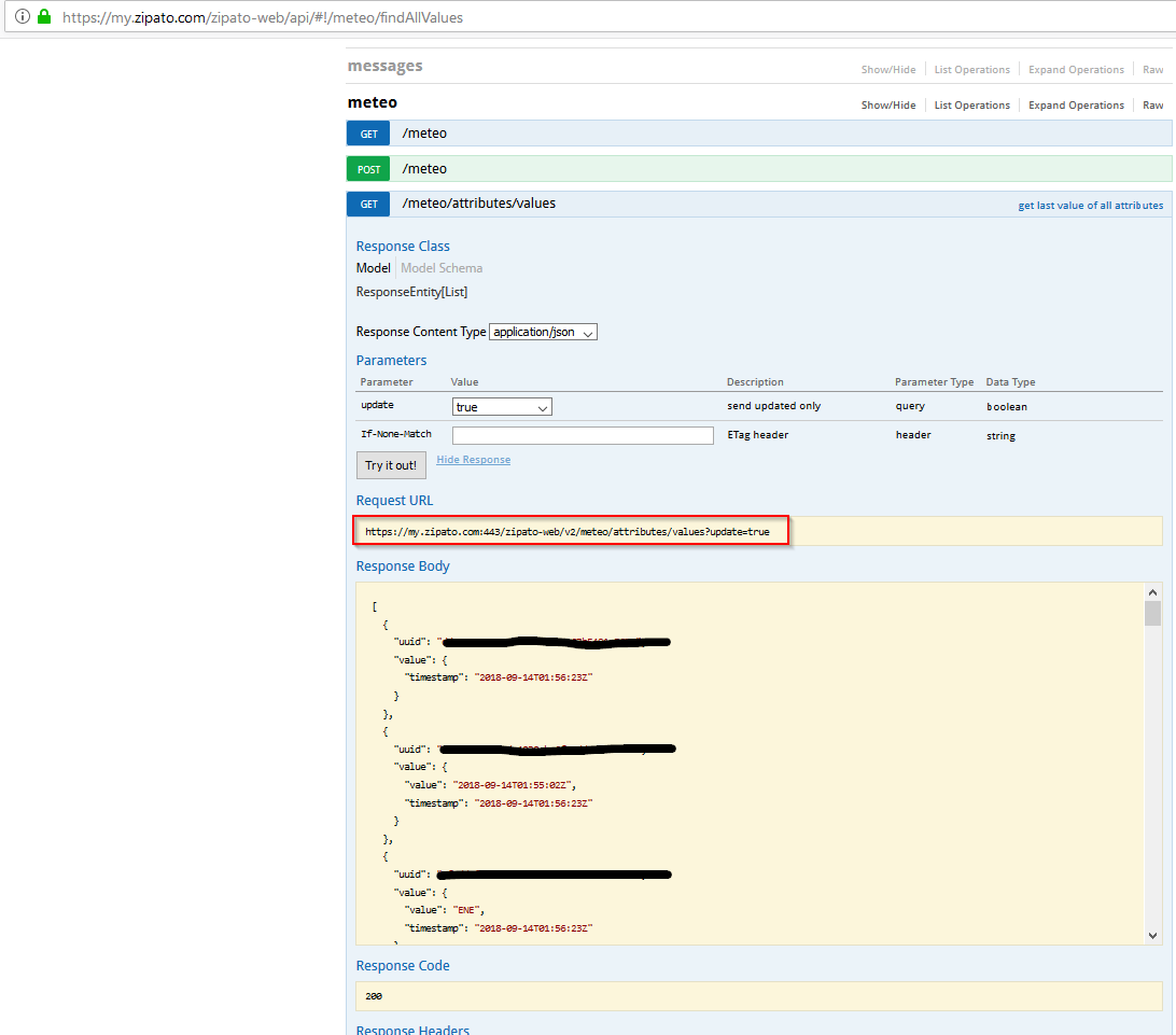

You can create a rule to update manually the virtual station, you need to go the API / Meteo / attributes / values, you can trigger this rule every day by using an HTTP puzzle with GET and the URL shown.
