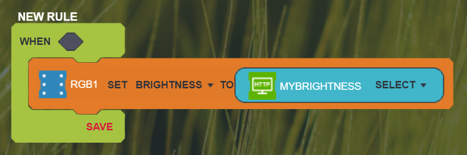

If you always want the same settings I recommend creating a scene insted, it's a lot easyer and cleaner.
If you want a variable version. You'll need to add a virtual level controll. And create a rule similar to this, you can add more lamps below the first one. Also add a trigger for the when block. Name it save, sync, profit.
If you want to set rgb you'll need to add a level control for each color. And set the color insted of the brightness.
