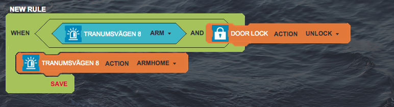

Hi, is there anyone who has built a rule that turns off the alarm when the door is opened by the door lock?

the picture was more a way of showing what I wanted to accomplish .

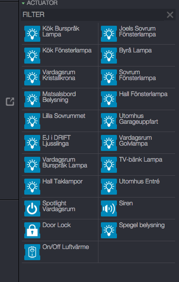

Under what category is it showing in the rule creator (under devices) ?
Lights and Power
Please note that arm state can be used in Rule creator as condition for triggering rules. To be able to use it, put Alarm in Sensor puzzle. Then you will have a choice to chose "Arm", "Disarm" and "Any" as condition for rule.
But remember, to be able to disarm your alarm with rule you must chose "Quick arm" option under alarm partition settings, otherwise it won't work.
