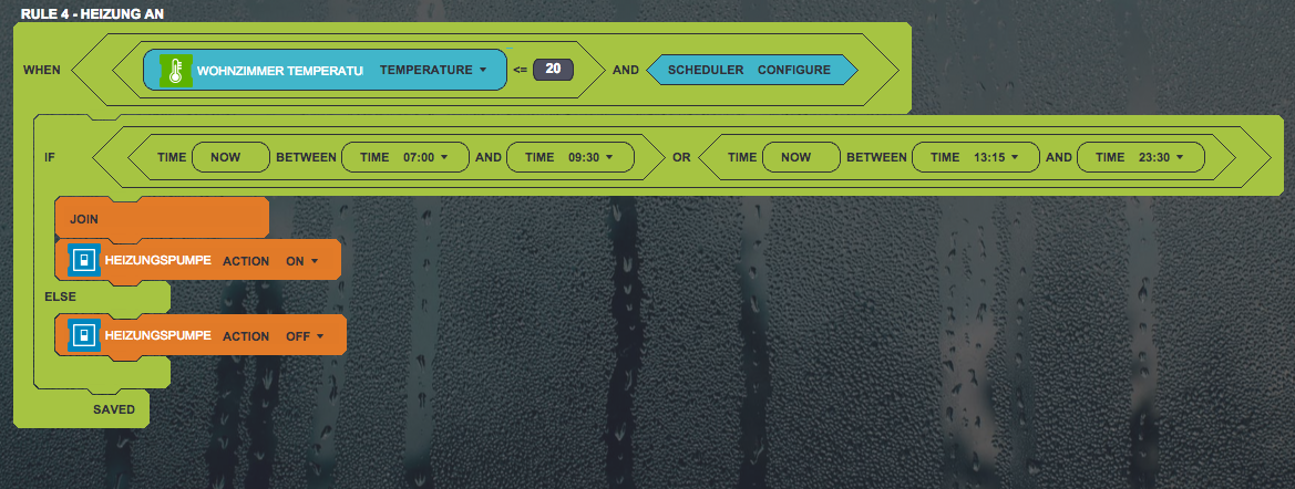

Hello Community,
i stuck here with a rule.
I have an on/off Switch, and on this Device i have a heating pump.
Now i want to switch this pump on when:
- Temp is lower than 22°
- on normal days
- time: 04-7:30 and 16:15 - 23:00
Can andybody help me with this?

Hi jki,
i thougt i could make a rule like this one i created, but its not working
Why don't you use the virtual thermostat?
Select that on/off switch for Heating Output
Select a thermostat device as your THERMOMETER INPUT
ok can you maybe give me an example for a rule and the virtual switch?

Rule works perfekt!! Thanks.
