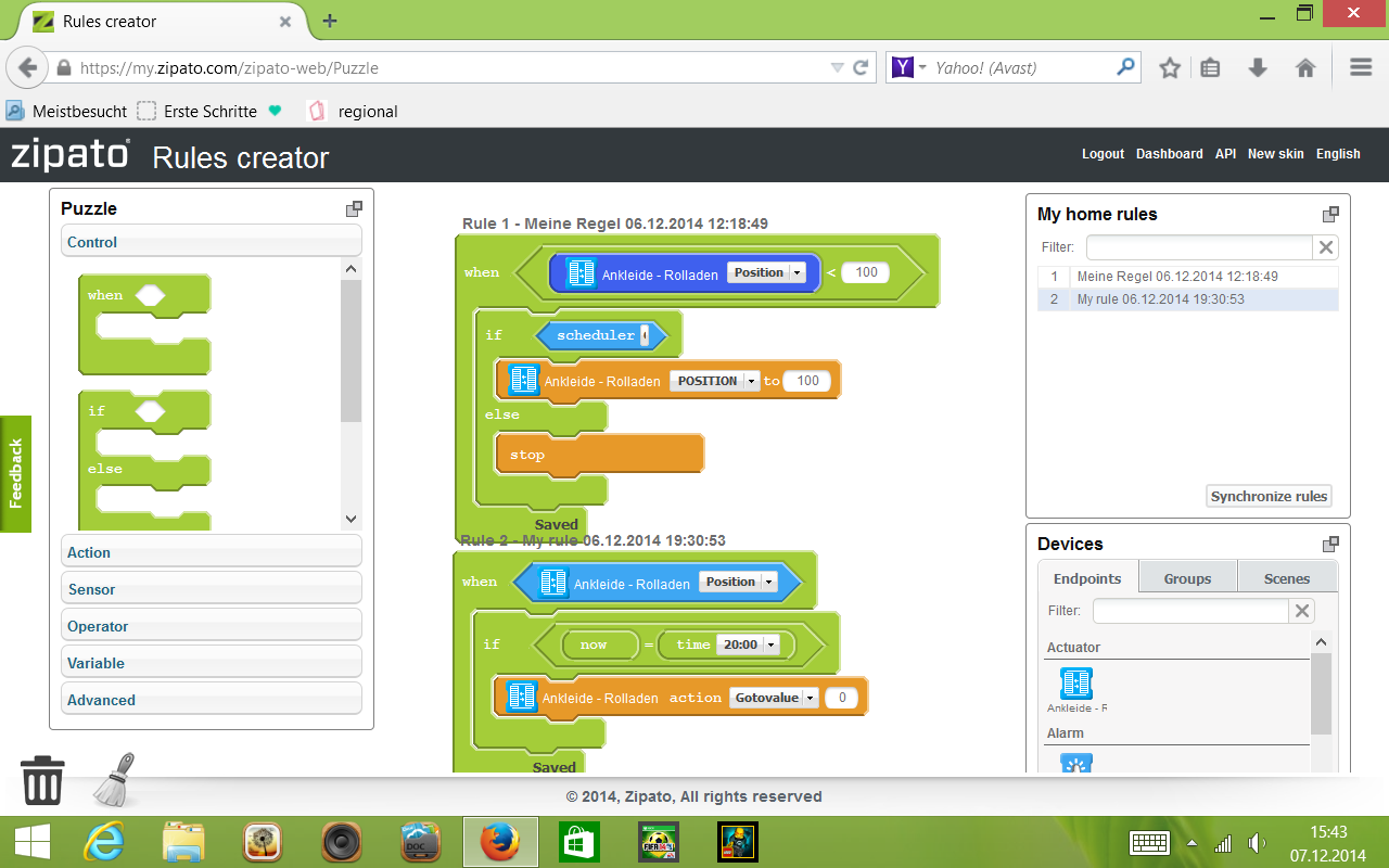

Hi again,
these are the last two versions I have tried. These might be too complicated ....
Any help his highly appreciated.
Regards,
Oliver
Oliver, your rules seems to be wrong.
What you need is to use scheduler as trigger and not in IF.
so
When (scheduler 1)
roller shutters position to 100
when (scheduler 2)
roller shutters position to 0
two very basic rules, scheduler 1 @7.30 and the repeat cycle you need.. scheduler 2 @20.00 and the repeat cycle you need to close the shutters.
Obviously you can add to these basic rules more conditions inside to avoid opening/closing in certain conditions and so on.
example:
When (scheduler 1)
if rain_sensor=true then ' if it is raining..
roller shutters position to 50 'half opening the shutters..
bedroom_light_dimmers to 50 'and turn on the bedroom lights to 50%
else
roller shutters position to 100 ' else.. full opening!
Hope this helps.
  • Sebastian..
  • This information is shared privately in spoiler and not visible!

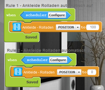

First success due to your help - many thanks!!!!!

Use the scheduler puzzle for this.
try to make two single rules first. These ones work fine.... see attachment.
