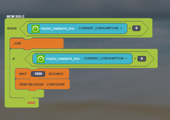

Hello Paul,
I would split the task in two, always easier to debug smaller pieces of code. First rule looks easier to achieve, when pump doesn't run for 30 minutes, see first rule attached. I used my energy meter PH1 for demonstration.
Second task will take a bit more of work, will post separately.
Hello Paul,

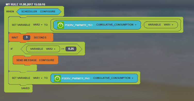

Second task could be acomplished with something like this, try it and let me know how it goes.
