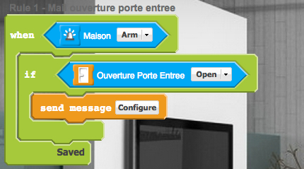

I've made a rule like this : "when alarm is ARM, if door is OPEN send email".

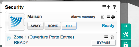

I set my alarm OFF but I still receive emails when I open the door. See attached files.
Can you tell me what I am doing wrong ?
Thank you
You need to do that differently
Option could be:
When Door Status ANY
IF Door OPEN AND Alarm=Arm
Send message
You could also use the Security option that is able to send a mail to a contact when alarm is triggered
