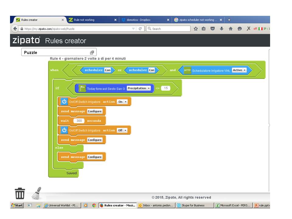

hi,
I am getting crazy with my rule number 4. it does not work.
I explain it.
basically with this rules I want to command the watering system. I created a rule to start watering in the morning (7 am) and in the night (24:00). but I ask to check both weather forecast (precipitation less than 15mm) and a virtual http actuator that I created (I use it in order to stop the rule whenever I want from my mobile phone w/o entering the zipato web page and disabling the rule). basically if the http actuator is on, the rule can start (if all the other condition are ok), otherwise the rule will not start.
now the question is that the rule does not work now.
in the past it worked but always giving problem (I had to reboot the zipato for ex.)
pls help.

rule attached again
rule attached again
rule attached again
rule attached again
ok, solved. to get it working I needed to switch in the rule "Schedulatore irrigatore virtuale" from actuator to control selecting as action the action event "on".
