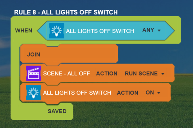

I installed a Z-Wave Switch at the exit of my house. The primary purpose of the switch is to turn off off lights when I exit house. The rule does work, but it works very slow. It takes between 2 minutes and 5 minutes to execute. I have a total of 32 devices all working on Z-Wave.
What could possibly be making it run so slow?
If I execute the rule from the Zipato program, it works very fast. I use a contact sensor when entering the house at night and find that when the contact sensor is broken the lights in the house turn on instantly.
Any comments on what to check for or how to correct would be greatly appreciated.

I think it's a bad idea that if a device triggers a rule with a ANY to also change the state of that device in the rule. This could potentially lead to loops (the JOIN complicates things even further). I don't know how the rules are actually implemented in code so maybe it causes some other weird stuff.
The following example is to show what could happen.
1. Starting situation: the switch "All lights off switch" is "On"
1. You switch "All lights off switch" to "Off" this triggers the rule
2. Run scene - all off
3. Switch "All lights off switch" to "On", the rule is triggerd again go to step 2 but because you have defined a join, the current rule executtion is stopped. So what happens now, is the state of the switch "All lights off switch" really set to "On"? Or because the rule execution is stopped only the event is trigger but the state hasn't changed? No idea.
You're starting situation is probably different but this is just to show the possible problems you can cause by change the state of the device in the rule that also triggers it. And if you als add a JOIN, who knows what will happen.
So my solution would be don't change the state. You can keep the any if but add an if statement:
  1. WHEN "All lights off switch".ANY
  2. IF "All lights off switch".ON
  3. Run scene - all off
Geert,
I have tried different versions of this rule to speed it up. Nothing seems to fix the issue. Your points above are most likely true. I have seen the rule go into a loop as you have said. I will change the rule to the above and let you know how it works.
I appreciate your comment.

You could easily change the rule above to:
  1. WHEN "All lights off switch".OFF
