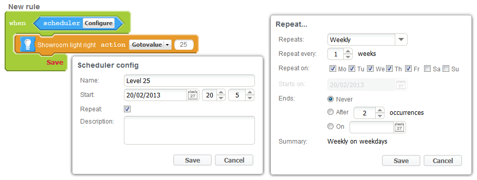

To accomplish this you need to create four rules with scheduler.
See example in the attachment for one of the rules.
Don't forget to synchronize your rules and box after you create rules.

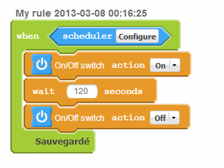

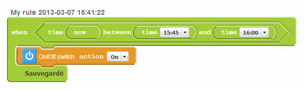

I first programmed it but it does not work:

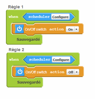

So I try that, it work but I find this strange logic:
The most logic to me is that but i can't save this rule :
What logic should we adopt ? Can we do this operation with only 1 rule and not 2 rule ?

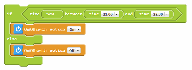

Also work : Regle04.png
You can use only one rule but 15 minutes for wait is to long, I wouldn't suggest using more than 5 minutes in wait puzzle. You can do it with one rule with 15 min wait. It is just much easier to find out what turned off light at given time if you are using two rules.
For your example I would suggest two rules with scheduler like you did in Regle02.png
