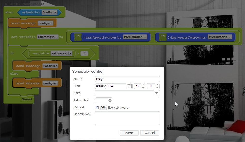

I have created a rule to start every day and depending on meters value it will do one action or another (see printscreen attached).
For now actions have been replaced by email to test the rule.
I put as initial trigger a calendar event with a date and time in a near futur and repeate action to 24 hours.
As soon as the rule start I send an email to inform me. After I calculate a rain forcast by adding next two days forecast.
Depending of result, I send an email or another.
Finally, the effect is:
The doesn't start everyday. Sometimes yes, sometimes not.
Sometimes I receive the first email and the second, but often I receive only the first !!! How is it possible ?
The rule never start at define time, but always at midnight :-(
Zipato, could you please tell me how to make this rule working.

To check the rule, set the SCHEDULER to do the same every two minutes. But remove the first message which is being sent anyway, as the RULE is trying to send two messages every time.

Now I have set the rule to start every two minutes and I synchronized.

Ok, every two minutes it works. Except that I didn't got the same number of messages. The first message that should always been sent has been received 37 times. The second, in the if statement has been received 43 times. No messages are in the spam filter.
How can I do now to run the rules every day at 5:00 ?
