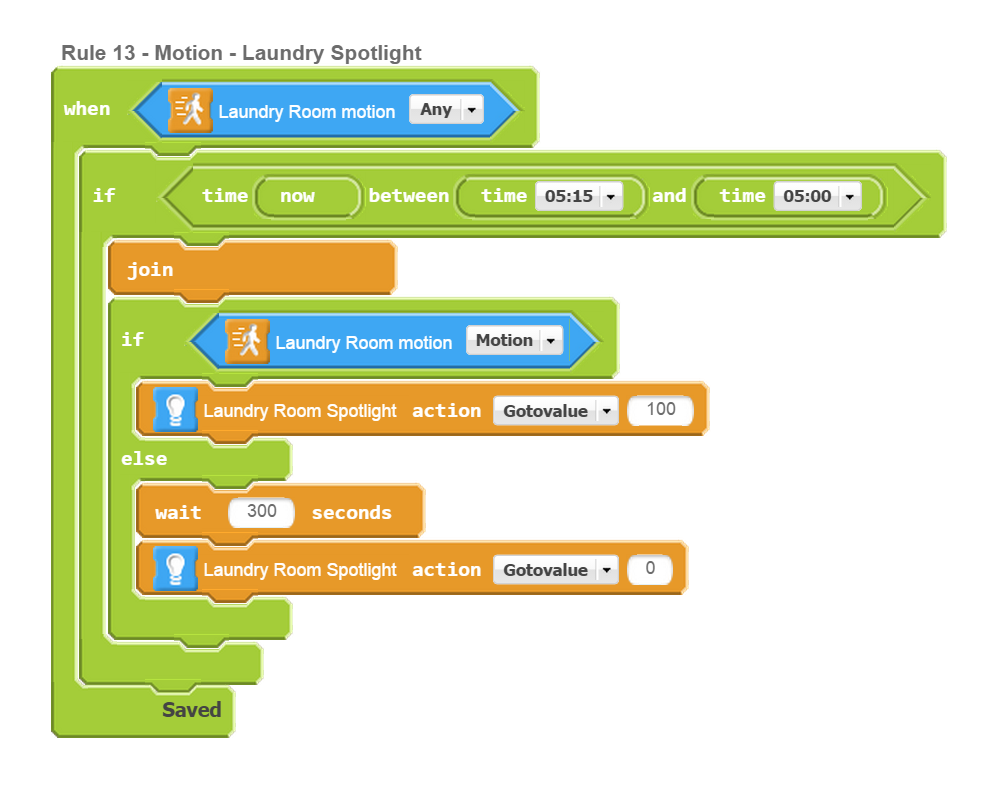

I have problems with all of my 6 "motion triggers light" rules.
They have been working for several months, but stopped working when new web layer was launched. Maybe a coinsident, but still anyway....
The problem with all of the rules is that the rules does not turn off the lights after no motion for predefined seconds.
Have zipato implementet new logic, so now i need to use refres all function etc..
Se picture. This is the rules that have worked for months, but now do not turn the lighs off anymore..
Please help. I have had a ticket on this issue for two weeks now, but no solution from zipato team..
I just read, that there is a problem with the wait statement. Perhaps you try without wait - only for testing!
Thanx, Andreas

Currently the only holiday we have is "Sunday". However we are working on many issues these days since we are replacing the old user interface with the new one. This is certainly critical issues, as there are more then just a few options available to users within a Zipato system.
As for this particular problem it has been fixed 6 days ago (as said by gregory)
