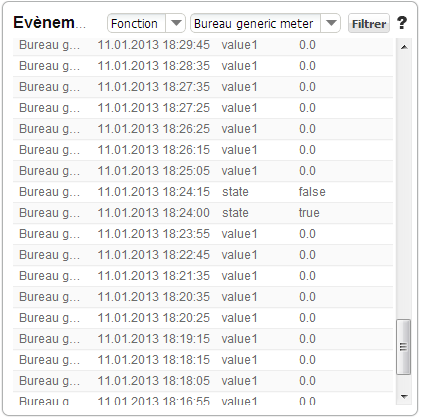

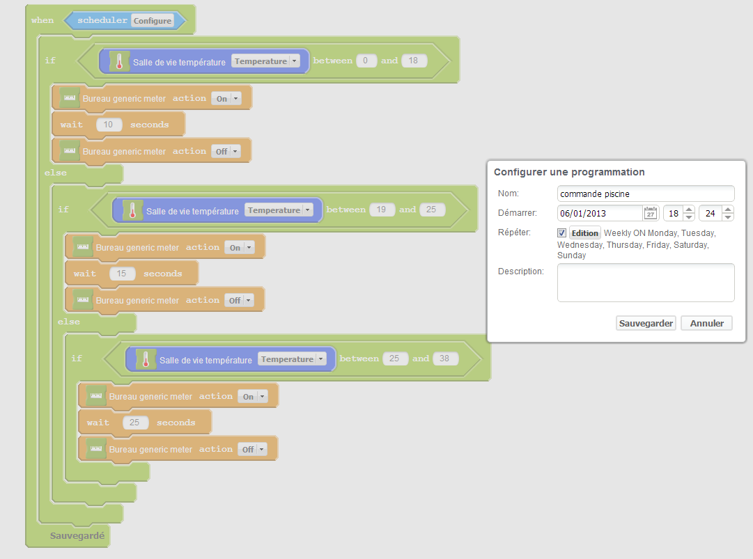

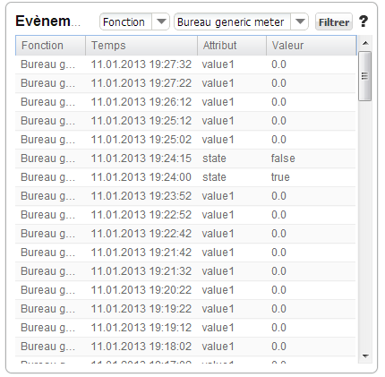

I noticed, that the rule with scheduler start at time and one hour after too.
Is there a probleme with my hour (France) and serveur hour (Croatia) ?

No, there is not a problem with timezone, we are all in CET.
The problem is that the box boots in GMT, and then changes the timezone with the configuration, and then recalculates the schedules. It looks like somehow the trigger survived that recalculation, and executed your rule once more at 18:24GMT. Most definitely a bug.
