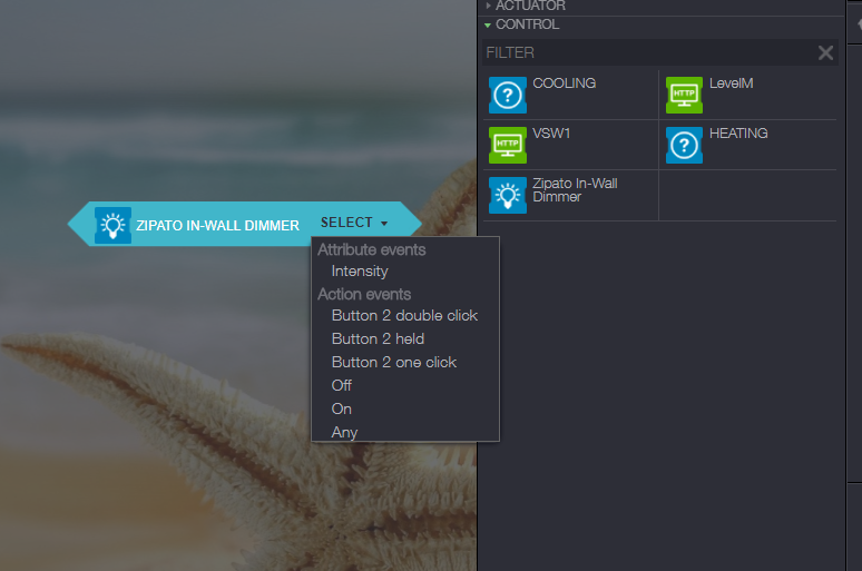

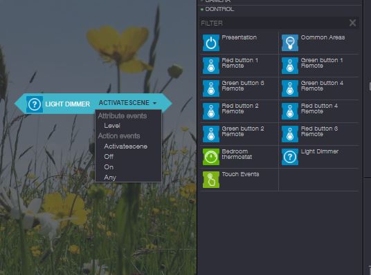

Have attached two pictures, which zipato says how it should be, check "Zipato wall dimmer", and mine "light dimmer" has only one activate scene attribute. I was suggested to exclude/iunclude which I did multiple times with same results. Anyone with correct or Incorrect attributes may pls chime in.
Zipato team has fixed it server side and now the scenes work.
