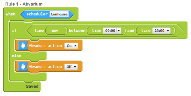

Yes, this works for me. Using it to control the lights on my aquarium. See attachment.
The "trigger" in the scheduler in the "when" statement that is set to run once every minute. So the rule is evaluated once every minute. Then the switch is set on or off depending on the time of day. So in effect it's turned on every minute betreen 09 and 23. But turning on something that is already on does nothing.
