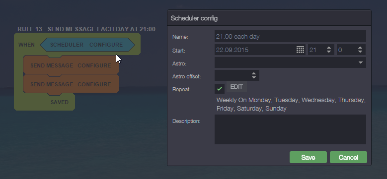

I'm having problems using the scheduler. When I configure a rule to send a message at 21:00, it will be sent at 23:00, 2 hours later than specified. I'm in Norway, GMT+1. In addition, it's summertime, which is +2 hours of GMT.
All logs and events in the ZipaBox is in correct local time. The only problem I have found is that the time zone settings in the ZipaBox does not persist after I click save. Anyways, I don't see this as a problem because all other timestamps in the ZipaBox is correct.
Does anyone know what the problem might be?
Screenshot of the rule is attached.

Zipato has reported that this bug has been resolved. The problem was related to time zone settings not being saved in main settings of the box.
I had to recreate the rules using the scheduler to make this work after the fix. Old rules created before Zipato implemented the fix was still stuck at incorrect time.
From my understanding, the scheduler configuration is not part of the rule settings, so make sure you create a new scheduler "instace" when creating the rules.
