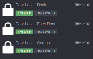

I have three Schlage locks and after great support by the Zipato team and some extensive trial and error I can confirm that the Schlage lock is fully supported by Zipato / Zipabox and that it does report open/close state, even when you manually lock/unlock the door.
I'm using the latest Beta Firmware (0.9.999.6d) on my Zipabox, but it also works with the latest official FW (at least on my Zipato Table / Controller).
The key to making it work turned out to be the need to have the controller close to the lock, by close I mean right next to it!
I had the controller roughly 2m away before and it would fail every time. (it would "pair", but no control or status)
When I placed the controller on the door handle during pairing... it was all OK.
I'd recommend using the "Controller Zettings >> Z-Wave >> Add Node" method rather than "Add device" as I had better success rates using that method.
