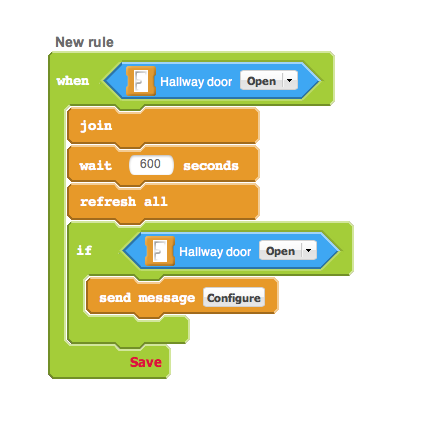

Hi, I would like to send an alert (email) if a door is open more than 10min (the door is not closed 10min after it has been open). Is it possible? If yes, any cloe about the rule to use? Thanks & rgds, Frankie
Not all the way... but proposal

Perfect, exactly what I need! Thanks. Why "join" and "refresh all", I have tried without and it also works? Rgds

According to My knowledge The join will "lock" the scene to not start all over again if closed and opened again. With join the counting will start at initial "open"
Refresh all, clear all possible cached states to make a confident check of door state. Please consider the answear from a rookie. I hope a PM can confirm.
