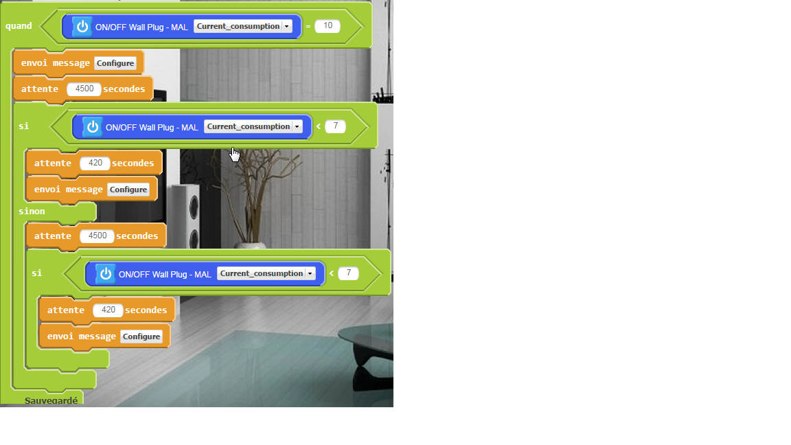

I would set up a rule that sends me a message from the time or consumption of my Wall Plug is greater than 10 (watch screenshot).
The power of Wall Plug varies greatly and is often reached 10 value, but
I would receive
the message one time only.
Because after I have somme condition to execute other command
What can I do this ?
thank you
kind regards

I would like some information when my washing machine...for my wife of course :o)
Begin cycle -> Sending a message
End of cycle -> Sending a message
Watch the attached file
Thank you

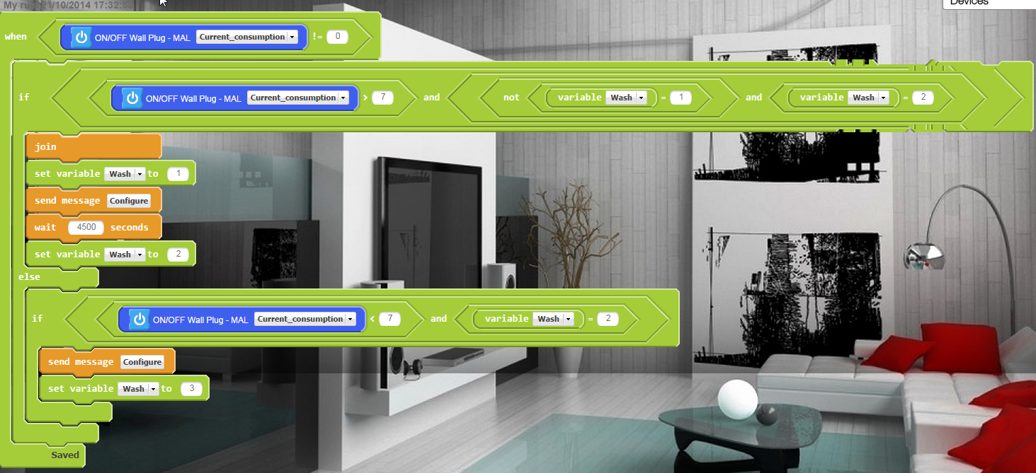

Not tested but something like this?
When Plug !=0
IF (Plug > 7) AND (NOT var Wash=1 and var Wash=2)
JOIN
SET var Wash to 1
Send mail
Wait 4500 sec
SET var Wash to 2
ELSE
If Plug <7 AND var Wash var = 2
Send mail
SET var Wash to 3

One question : How to create variable in a rule ?
Right panel >> Variable >> New variable
I created the variable but where I can find it ?

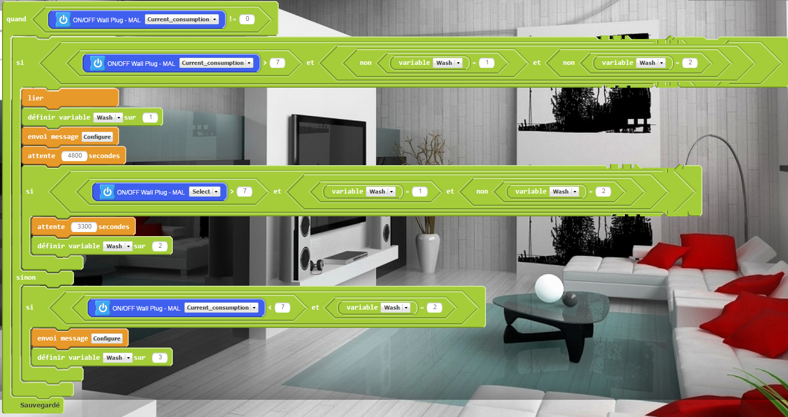

The screenshot's rule....

I can try the rule (See last post with screenshot), but I never receive mail.
I have make some error ?
Put a NOT in the var 2 (top one).
Thank you ! I will try the rule at the next wash....
I tried the rule and it's OK.

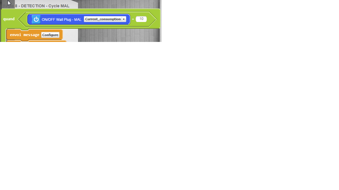

I changed it because my wife uses 2 wash progams. One program that lasts 75 minutes and other that lasts 135 minutes.
Can you tell me if my rule is correct (attached file)
Thank you
Thank you
