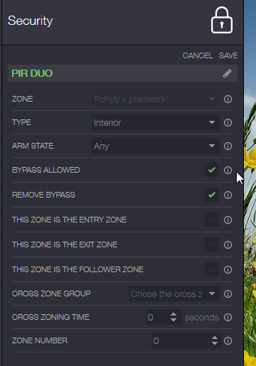

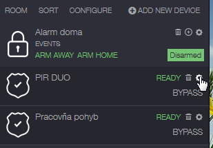

Hi, see the attached printscreens. Go to the alarm, open the settings for the specific zone (sensor) and check bypass allowed and remove bypass.
Now you should be able to alarm the system without waiting the sensor to change state.
