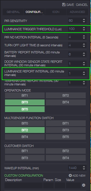

You are correct sensors are independent however, most multisensors have a "main" sensor, usually this main sensor triggers "updates" for the others, in the case of multisensors with motion sensors usually this is the main sensor, sometimes is the door/window sensor, also in most cases this is configurable. In the case of the Quad Sensor, motion is the main "trigger". Sensors usually work in two ways, first is one called "unscheduled events" which are configurable and usually are "motion" or "door close/open", in case of meters usually this is triggered by a threshold of change, this means that the sensor will update the controller whenever there is a change of more than X amount of lux/% change (you can see my screenshot I set it up at 100 lux change), the second way is a "scheduled event", this means that the sensor will update the controller regardless of the state of the sensor, after a certain period of time, you can see my setting is at 30 min interval.
As Klaus mentioned, if these events are configured to be shorter/more sensitive the sensor will decrease its battery life, you need to play with it and find the sweet spot, usually default values are ok for most scenarios but you may have diferent cases, for example, one of your sensors could be more exposed to sunlight than others so you may want to make this threshold a bit bigger.
Change these two parameters and see how it performs, you might have to decrease the lux threshold report value.
Please do not confuse the scheduled report events with the "wake up" event, this is a completely diffent event. During a wake up the sensor reads the controller for configuration changes and sends a "heartbeat" signal to the controller to let it know it is still there. Report events might come right after a wake up but they are not the same.

Thanks klaus and alberto
But then how would I make the illumination sensor work without dependence on the presence sensor.Would be changing the values he shows me in the image of Alberto.
