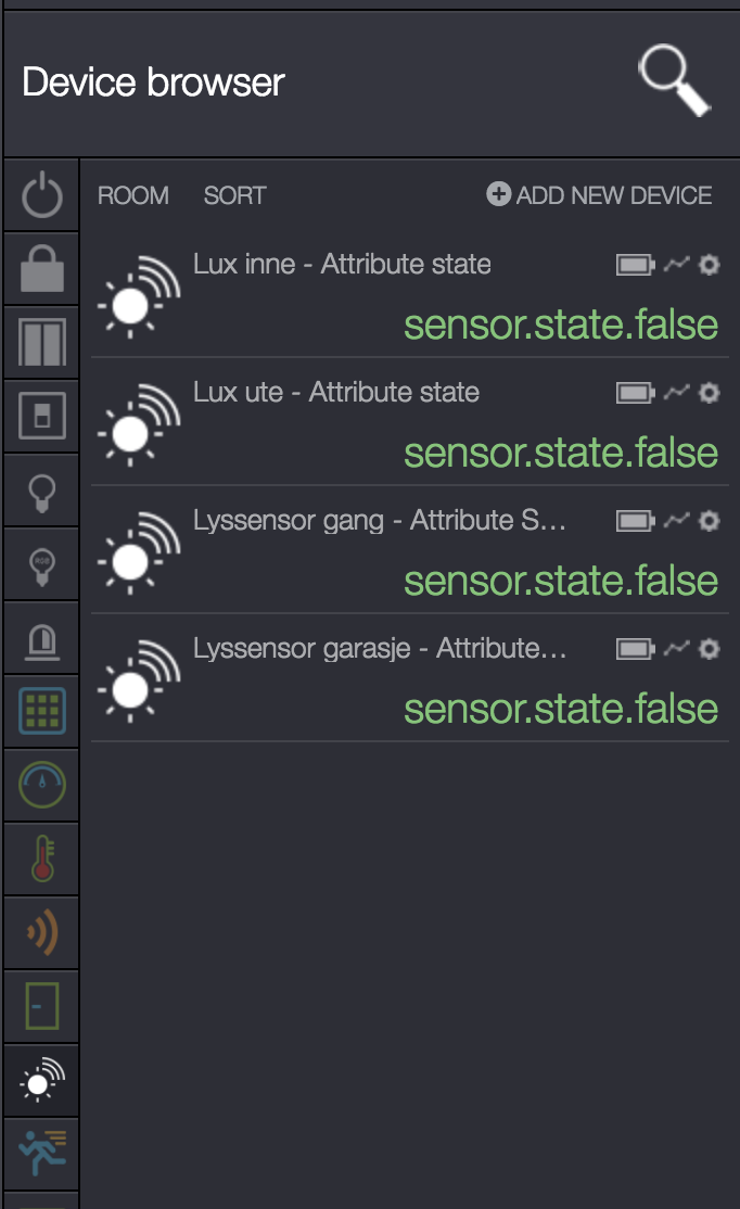

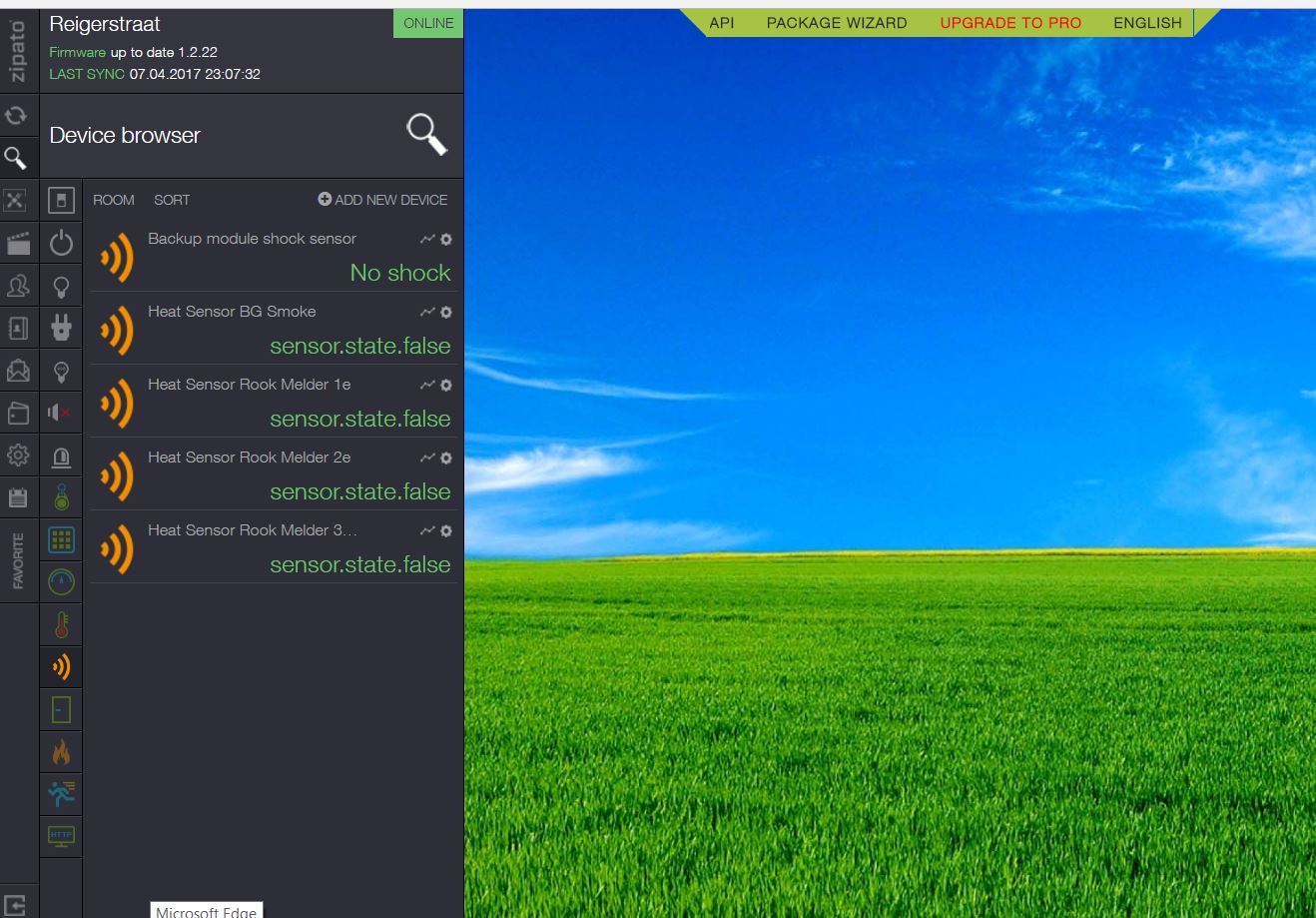

I Just upgraded to FW 1.2.22 and now a lot of Fibaro sensors show: sensor.state.false and don't change state anymore. In the (iOS) app they still show as normal (Motion/No Moition, etc).
Already tried reset en re-inclusion but no change.
Anybody else has the same problem?

Go to the device setting and see if correct device type is selected.
Also it might be that the wrong endpoint (wrong level) is showing.
