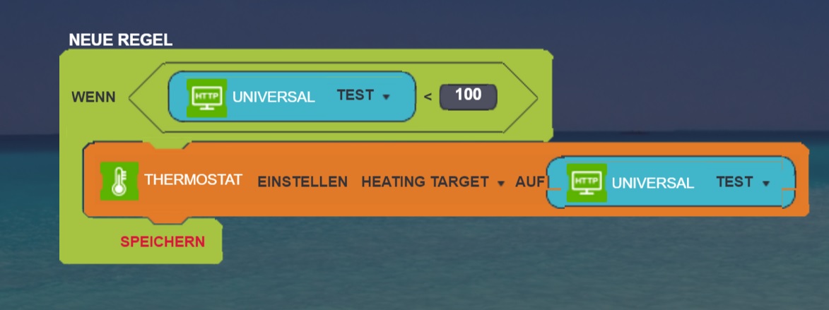

You can make it through a virtual meter or virtual thermometer.
There you set the desired temperature on the url.
Then you create a rule.
When: virtual meters
Then: set-temperature / virtual thermostat - Set to - temperature (virtual meter)
