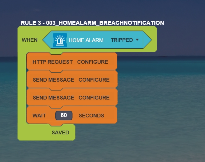

2. I configured for testing purposes the reports in my alarm but looks like a couple of Fibaro Motion sensors are configured a bit to sensitive, while I figure out a proper configuration for those I realized the notifications are sent too often so instead of the report configuration I have created a rule (attached), do you guys have experienced similar issues? how you fixed it??
