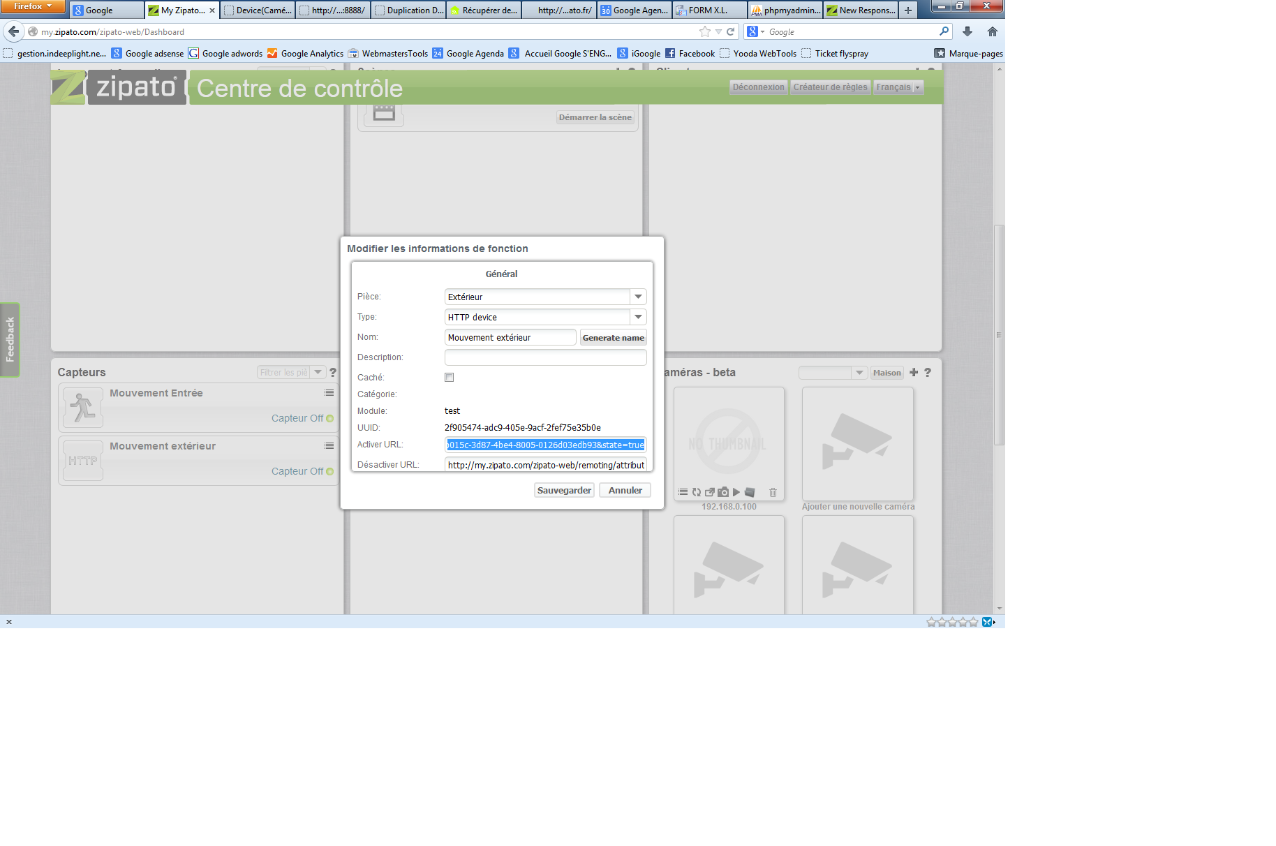

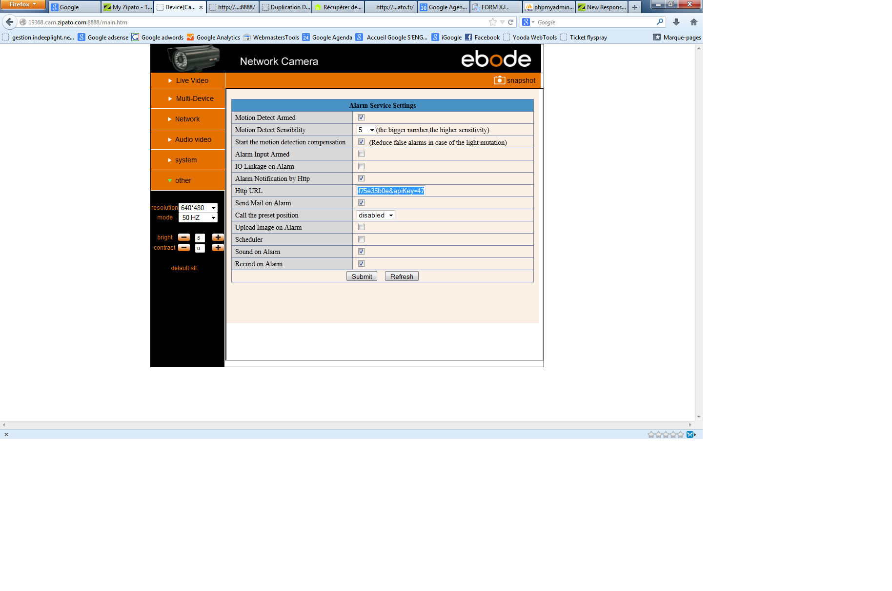

I just installed an ebobe IP vision 58 Camera who is working quite fine with zipabox.
Then,I created and "http device" (to gather cam's motion detection alram) but the "active URL" guiven by zipabox is too long and was truncate when i pasted it in the camera setup software.
you can have a look on the 2 screenshots include in this post.
