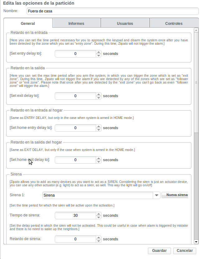

I have a Fortazz SSA2 siren. I have selected as a siren when the alarm is activated, but it does not sound and also lights are off when any event occurs.
Is this a bug?
