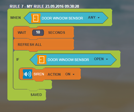

I have a ZipaBOX and a 3in1 Zipato sinsor. I am trying to right a rule that allows me to pass through the door and within 10 second nothing happens. But if the door is ledt open longer than 10 seconds the siren will go off. Then the siren turns off when the door is closed (Contact)
Please help. How to I right this rule?

please see attached screenshot - maybe my solution can help you
THank you so much for your help.
Now how do I tell the siren to stop once the door is closed
try to make:
WHEN <<DOOR ANY> AND <SIREN ANY>>
IF <<DOOR CLOSED> AND <SIREN ON>>
SIREN ACTION OFF

basically you need copy/modify my rule and
You can set an ACTION on your SIREN to TOGGLE IF DOOR is OPEN
for RGBW you can set an WAIT 60 SECONDS then an ACTION RGBW (pick blue)
and a ACTION GOTO 100
