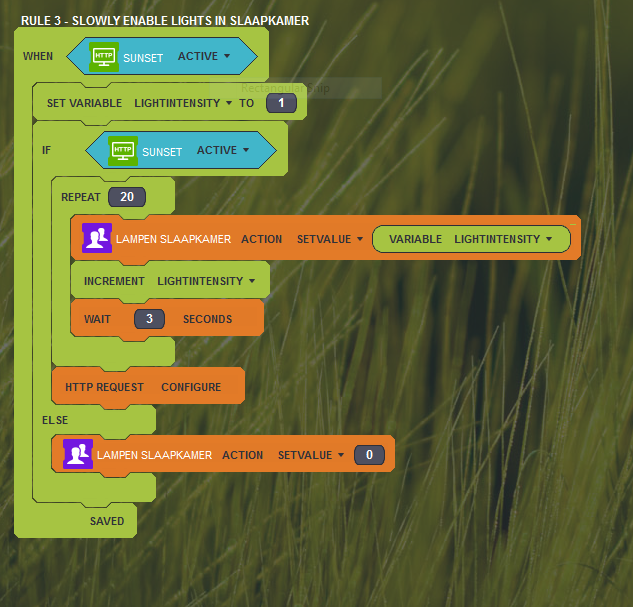

I did just that this week, ended up with the following rule.
It's triggered based on Sunset minus 2 hours (to account for dusk, while i wait for my multisensor to arrive..), and should increase brightness from 1 to about 20% over the period of 1 minute.
