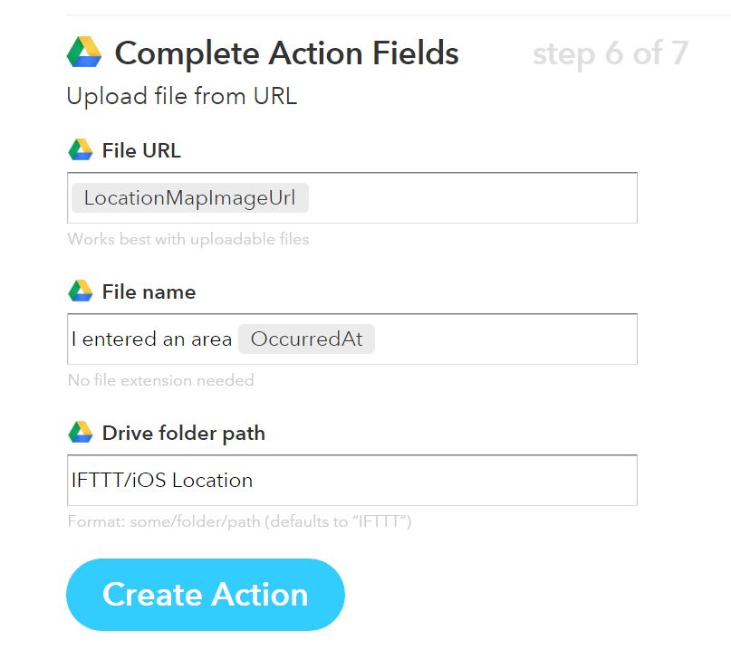

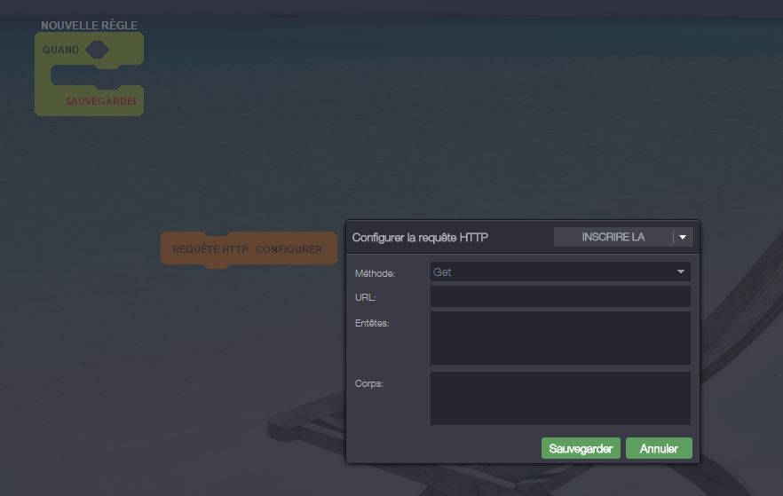

Hi to all
i have a big problem to configure a request with the recipe of ifttt that is:
Ios Location / Google drive.
I don't understand the principle of application i'm too bad :-)
I have the ifttt and google drive accounts
i have the recipe IosLoc/GDrive
I do not know what to put as links in implementation as the pictures in attachement
the aim being to be able to trigger a scene of closing / opening of shutters
thxs to all !!

Look at knowledge base for ifttt. The trick is to use a virtual meter and to change its value via ifttt. You then can read the value of the virtual meter in a rule and make some actions. Works very fine and is really easy. You do not need http requests, because the value is changed directly from iftttt, because a virtual meter has its own url.

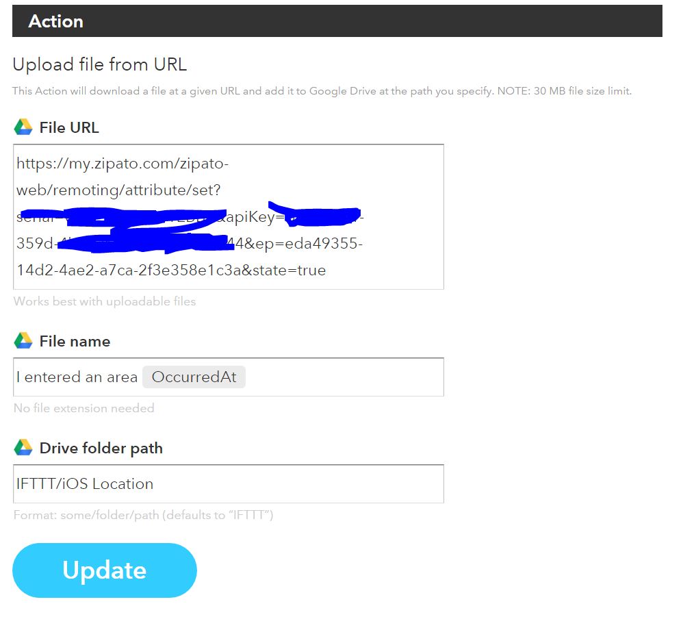

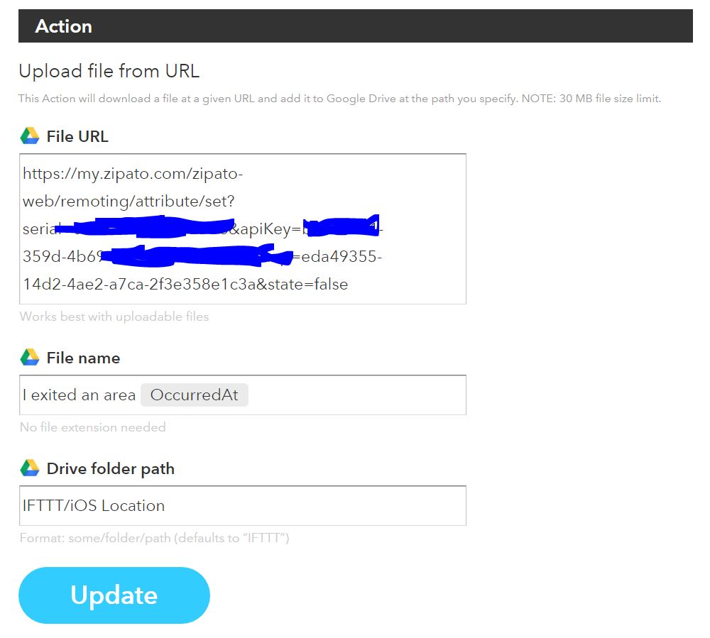

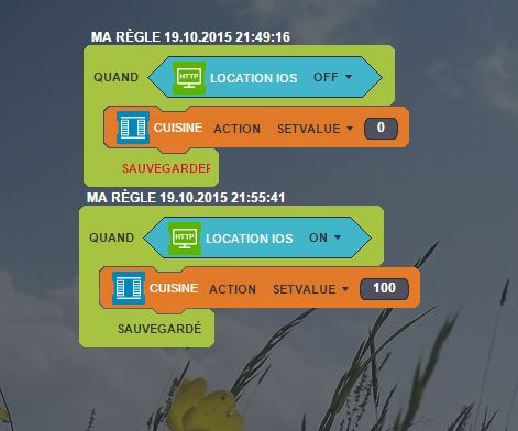

IS THAT RIGHT? with this configuration ?? see attachement please thx a lot !!
I can test this one tomorrow
thx all in advance

With IFTTT you can now send a http request with out the use of google drive. With the MAKER channel you can do this.

the two rules work
Thx to all !!!
