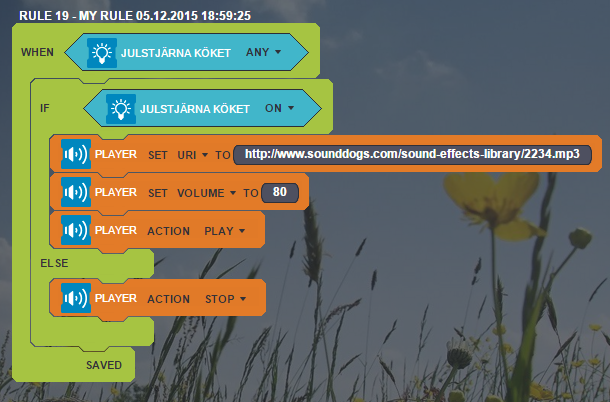

See below images of rules from another post I found regarding Sonos, I cannot try it because there is no support for Sonos bar yet, hope it helps...

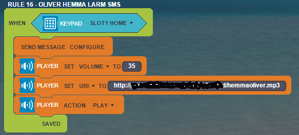

the ruleexamples are from a post where i explained how i did it. Its not a problem with zipato. I just disarmed 20min ago when i got home with the rfid and my sonos said, Welcome home Oliver :) You´re not doing it right...

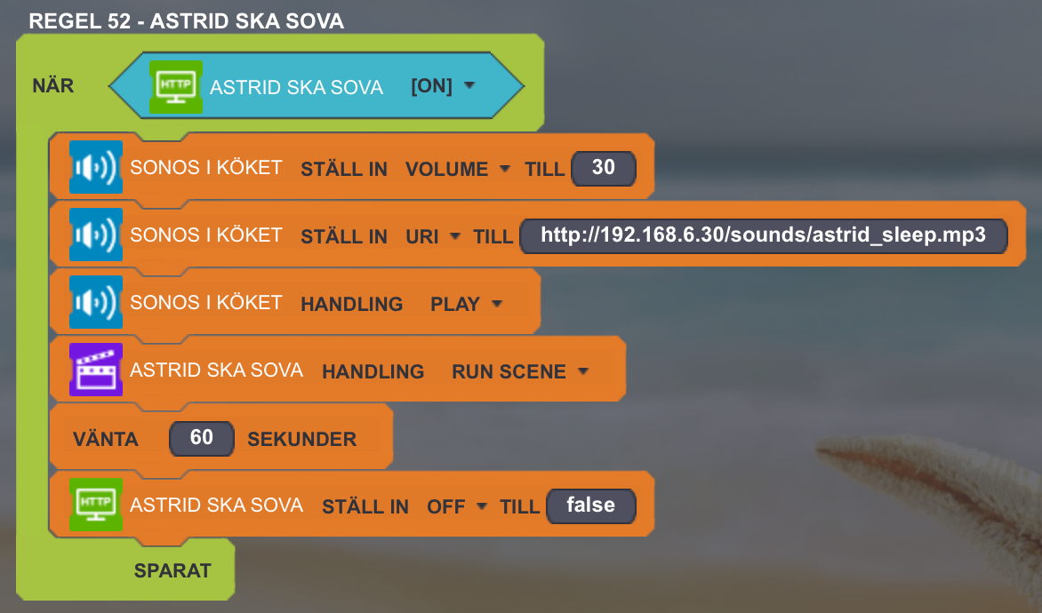

If you see the attachment: (Its in swedish but I think you will get the idea)
This is a rule that creates a specific scene when my 2 year old daughter shall go to sleep.
She gets to press the button her self. The light scene activates and the sonos plays a little song. And she likes it :-)
Steps:
I use a virtual switch to activate the rule

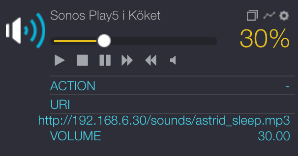

Then use
SET block to choose a volume level, in this case 30%
SET block to add URI, in this case a local web server I have in my network
ACTION block to PLAY
ACTION block to activate scene
SET block just sets the switch back to OFF
I hope this will work for you all
