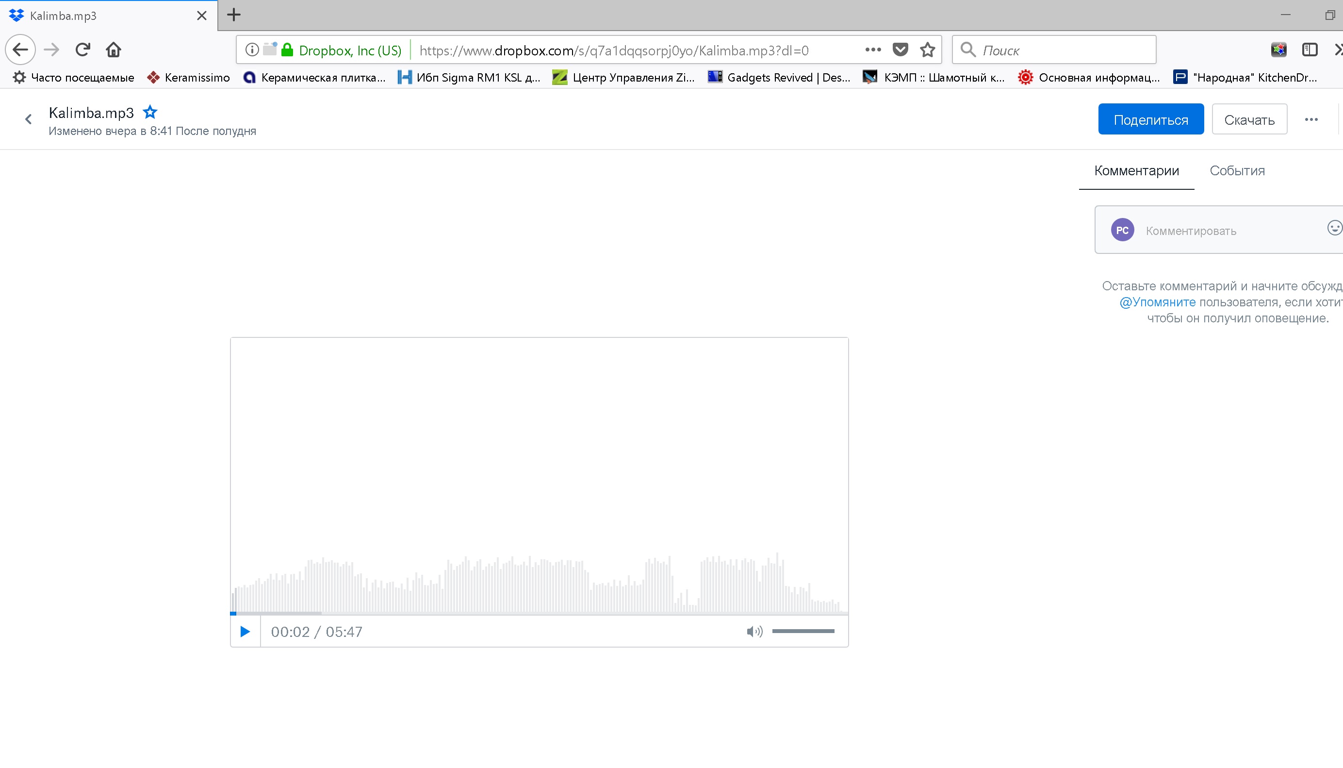

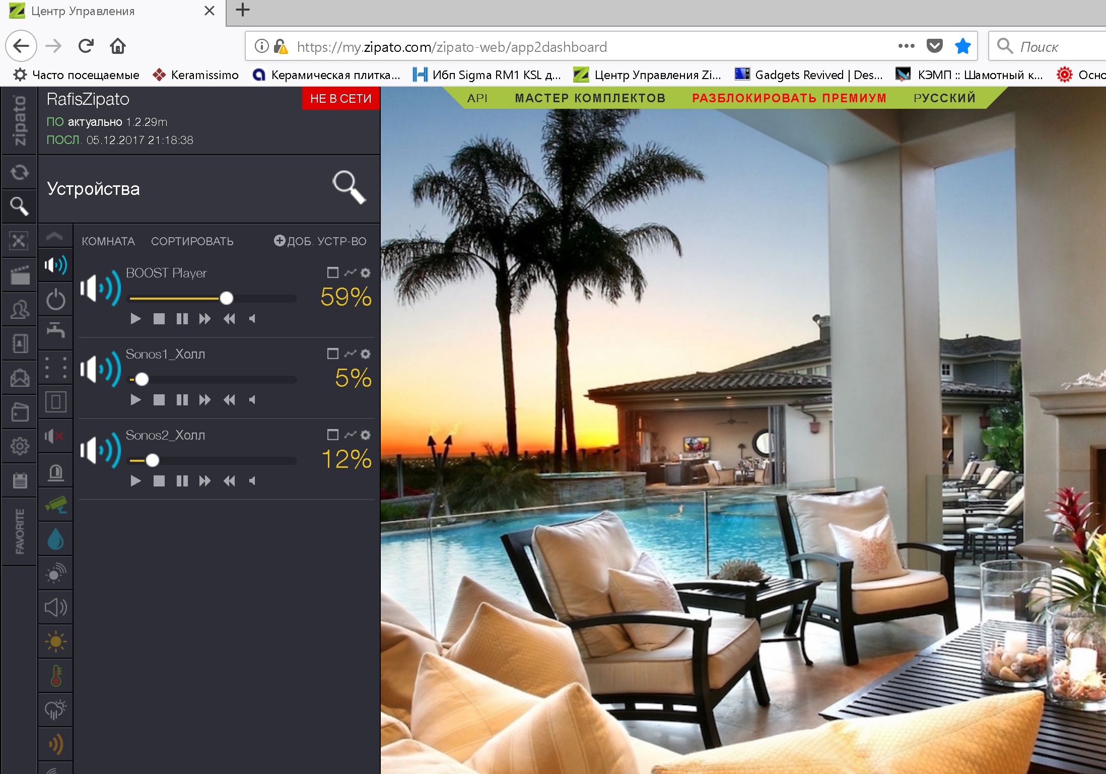

1. I installed a Sonos device, I got a Sonos Boost and two Sonos Play 1. Sonos are controlled from a web browser.
2. Create a rule for playback.

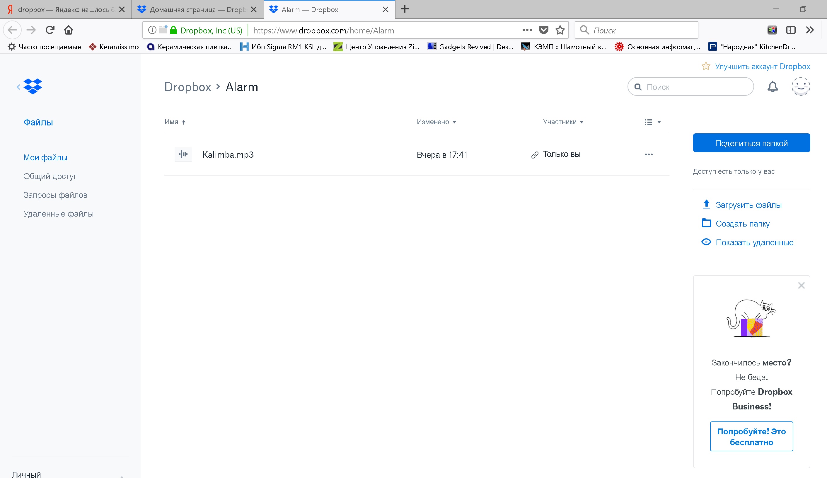

3. Created a folder on https://www.dropbox.com
4. Placed in file folder

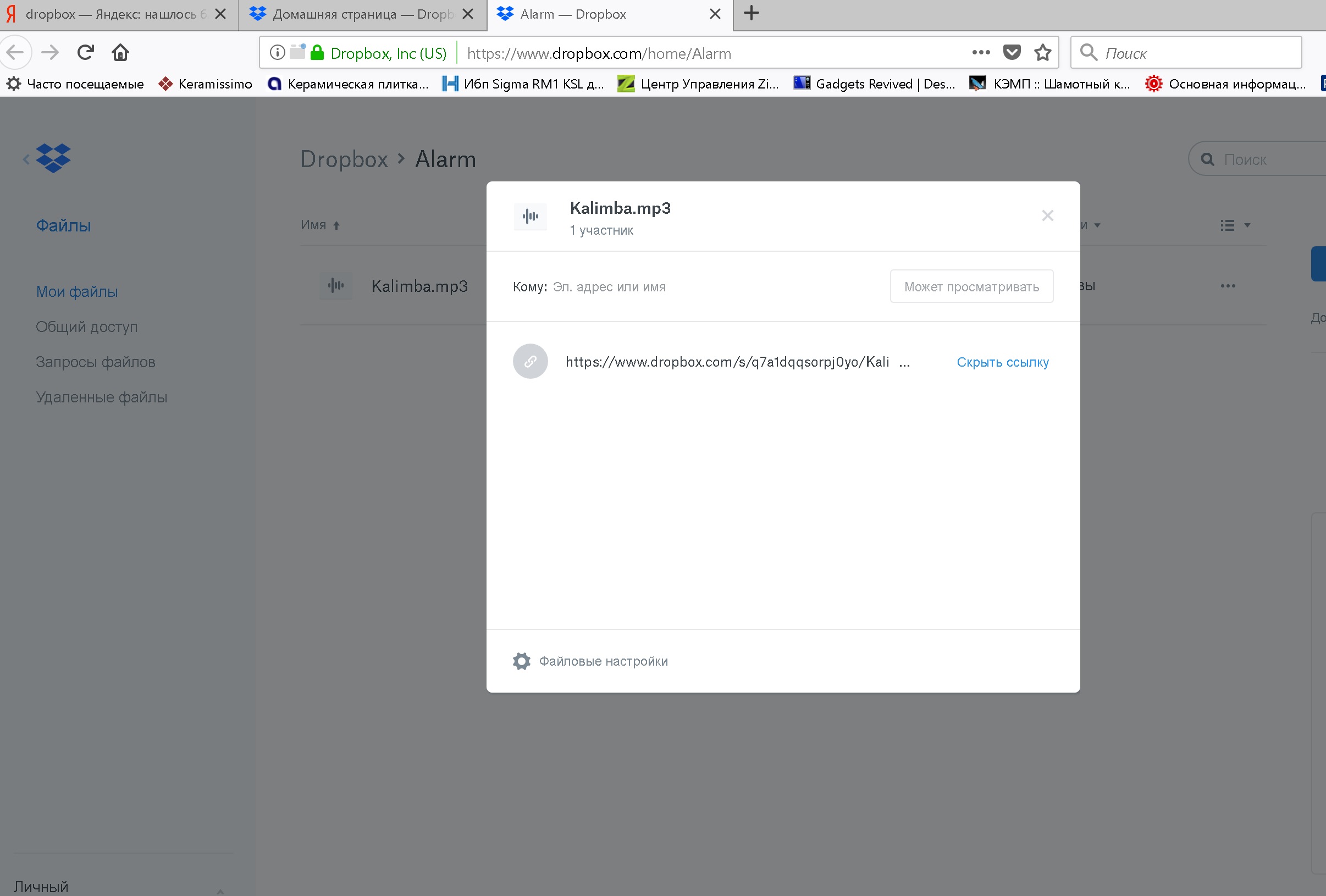

5. Copied the link to the file. Link opens in the browser.

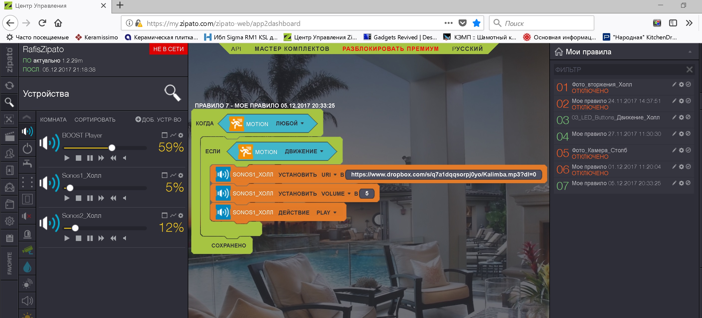

6. Made a simple rule. URI put the link to the file
When implementing rule changes the sound, but playback is not happening.
What am I doing wrong?

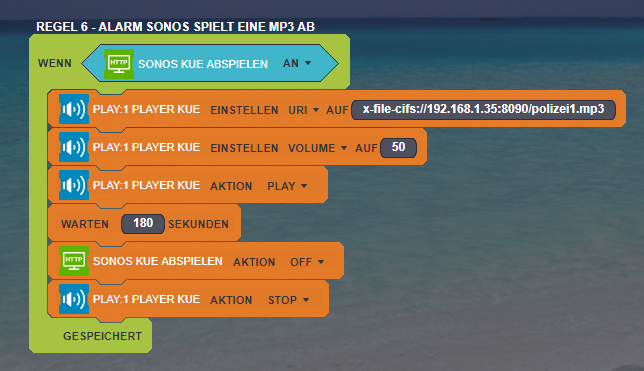

Sonos integration is not easy :-) Because I cannot read your rules (do you use action or set for play and volume?), I just guess. I never tried to make it run with dropbox. I use a simple web server running on the zipatile itself. URI points to that file. I use "x-filecifs:" instead of "http:". In your context leaf ?dl=0 at the end. You have to set volume too. Than play.
Thanks for the comments.You 198.168.1.35:8090 what is that device? I would like to play files for different scenarios, it is possible from SD card external Zipatile. How it will look in the URI for playback from the SD card external of my Zipatile?
As I said: this is a mini webserver running on the zipatile. The shown IP with port 8090 is the root adress of this webserver. I use PAW server (android). I never tried to move it to the sd card. Try it.

u need to put this MP3s Files on a Webserver. Thats not Dropbox.
I think you can install an App for this on your ZT. Or if you are running a Raspberry I your Network, you can install a Webserver there.

Copy the files to a USB device and plug it into the router. You will probably need to play with the settings on the router to make the files available (look for USB/file sharing). Then you need to find out what the UNC file path is for the shared folder. It will look like this: \\<USBDeviceName>\<SharedFolderName>. You should be able to see it by looking at the network folders visible on your computer. You might also see it in the router settings.
Once you have got this far, just set the URI in the rule to:
x-file-cifs://<USBDeviceName>/<SharedFolderName>/MySoundFile.mp3
You can also test that the rule works with this sort of URI by sharing a folder on your computer and putting the file there:
x-file-cifs://<ComputerName>/<SharedFolderName>/MySoundFile.mp3
