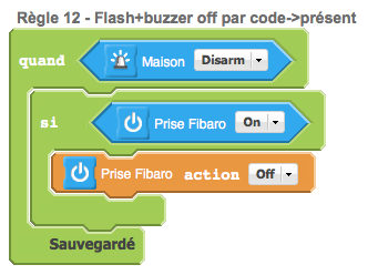

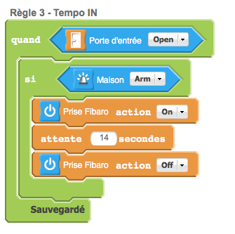

I had the same question, I just bought a Zipato Keypad but it's buzzer does not act as a time-in / time out buzzer.
I used a workaround with 3 rules and a Fibaro Wall plug. Plugged a lamp in it for tests purposes, I will use a buzzer or flash light later if it works as I want.
Tempo OUT : When arming system, wall plug is activated for 14s.
Tempo IN : When system is armed, opening the door will trigger the WallPlug for 14s. If no disarm command : alarm.
Bypass : Will switch the WallPlug Off when system receives Disarm command between 0 and 14s.

Entry and exit delay are set in the Partition and I use the same value in the rules.
The Zone type has to be set as "Perimeter" for the delays to be functional.
