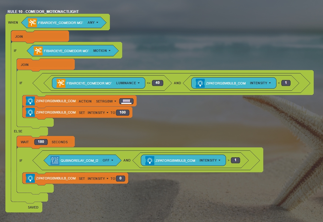

Usually for these type of sensors you have to use the "METER" puzzles and operators to make the condition you want. i.e.
WHEN Temperature > 25
ACTION Turn ON Fan
The settings you are talking about only change how often update the sensor/meter status in the zipabox. See attached rule I have for turning ON a light when motion is detected and luminance meter is below 30 lux.
