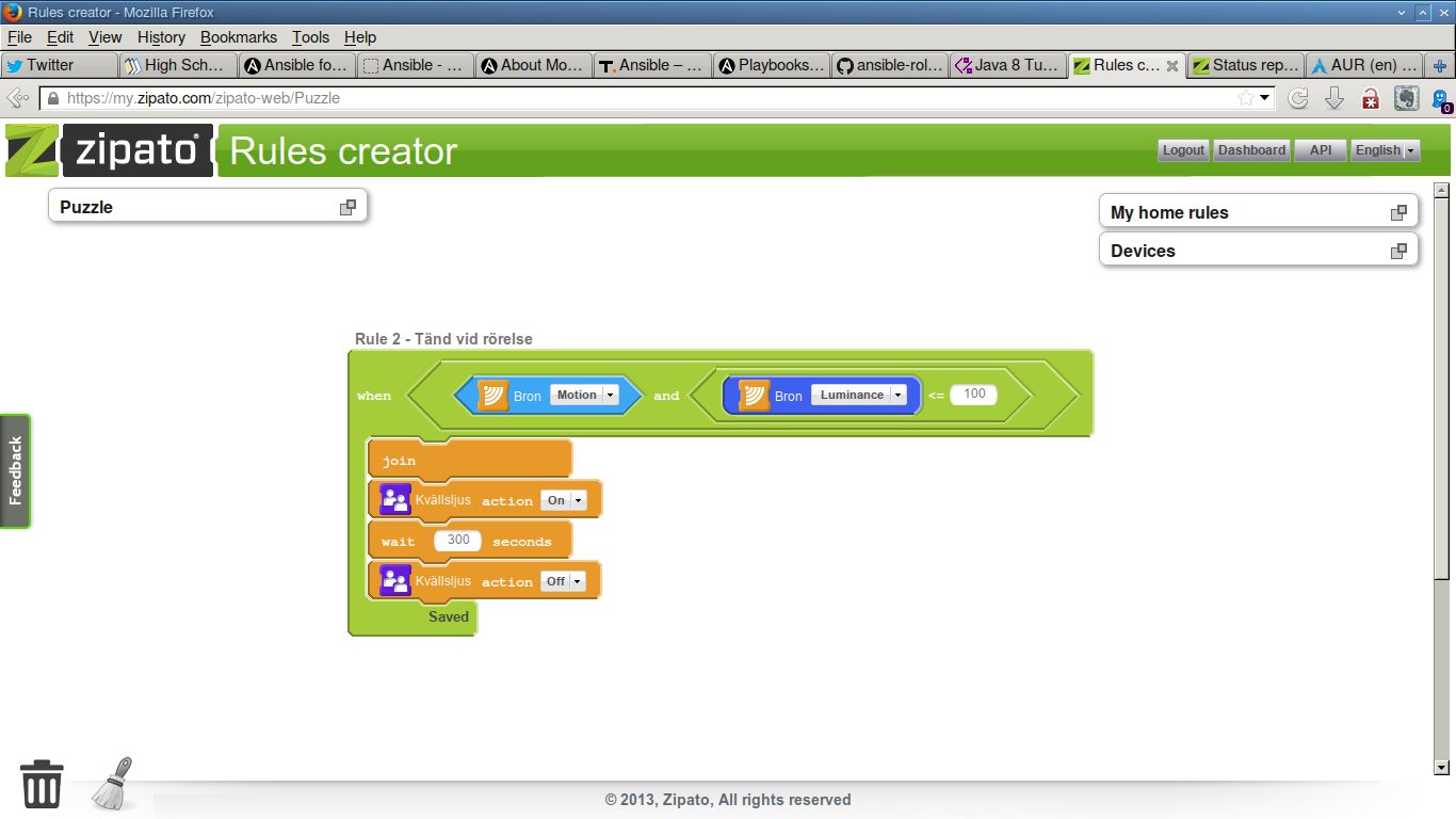

I am using the in-wall switch from Fibaro called FGS221 (reported as "FGS221 - v2.1". When I use the Dashboard the status of the switch is correct. However, when the status is switched using a rule, the status of the switch gets locked to the first setting in the rule (action "on"). The status starts working again when using the manual switch connected to the Fibaro.

Can you post the rule?
Here it is. "Kvällsljus" are a group of three Fibaro in-wall switches

Try without the groep...i don't use groups because sometimes they give problems.
Also for testing put some e-mail checks to see where the rule stops.
I did not change the using of group (tnx for the tip!) and for some reason when the sensor trigged the rule today, it all worked. It is like it takes time for sensor and devices to settle in. Will update if problem re-occur. Thanks again for your comment.
