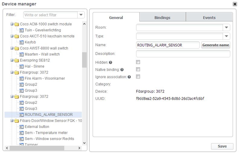

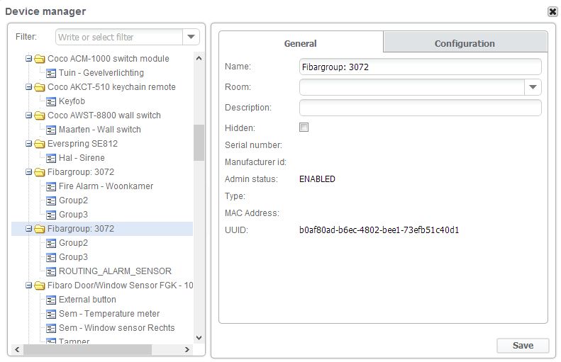

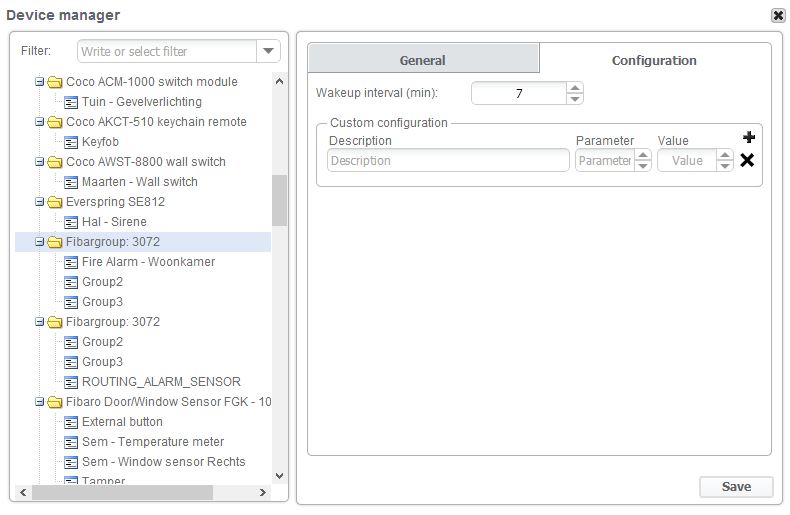

I just added the Fibaro Smoke Sensor and out of the box it's not working.
The device is seen as a Routing_Alarm_Sensor and you will need to change it to a Fire Sensor. For as far as i know you should also be able to messure at least the temperature and get the status of the battery.

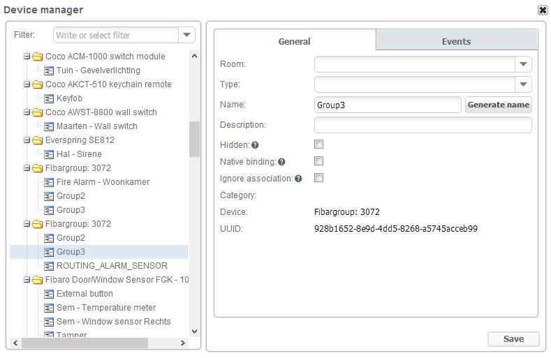

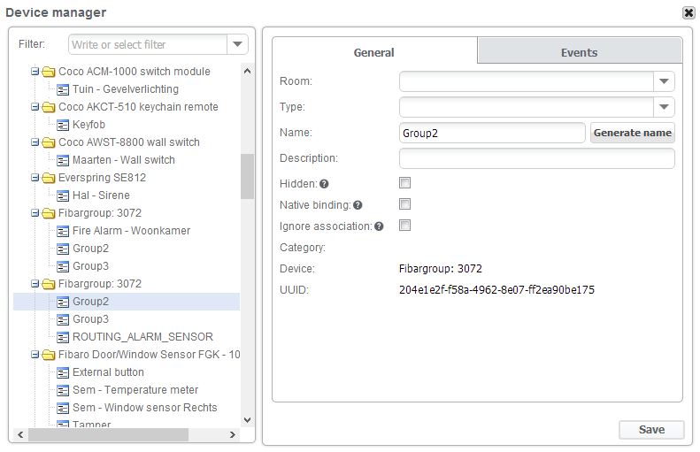

I tried to change the device type of the GROUP2 and GROUP3 items in the device settings without any luck.
I attached the screenshots i made directly after i added the device to the Zipato Box.
If anyone has idea please let me know.

Hi Slash,
Thanks for the screendumps. To bad it's not working out of the box. Can you cannot support about this?

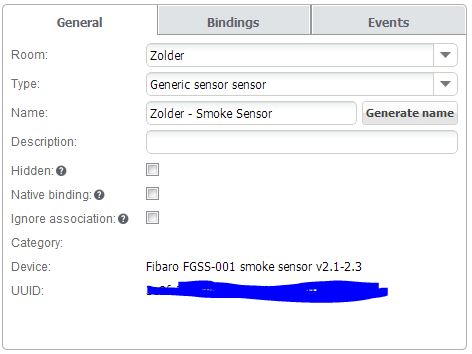

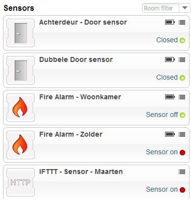

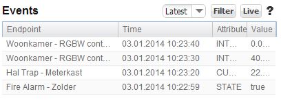

I triggered the Smoke sensor (i used an e-sigaret as the provides fake smoke :) ) and can see the detection in the Zipato Control Center.
Once i stopped the alarm i still shows "sensor on" (smoke detected) after 15 minutes in the control center. Also after a reboot of the Zipato Box the sensor still shows as smoke detected. There is also nothing that provides the ability to acknowledge the "alarm".

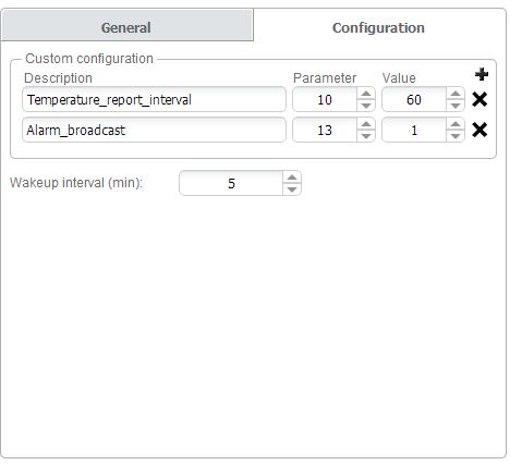

For as far as i know you can set Param 10 (Temperature Report Interval) to 1-17280 (5sec-24h), the default is 0 that means No report.
Param 13 is for Alarm broadcast mode
I tried settings these parameters but had no luck getting the temperature metering show in my control center
Maybe i am doing something wrong here, any idea?

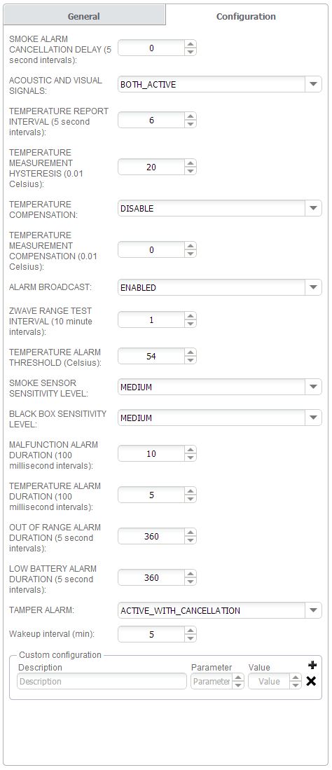

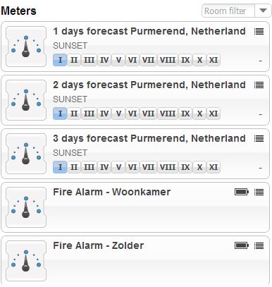

Device is seen as Generic Sensor Sensor. I hope that Zipato changes the way it's displayed to a Fire sensor. Also the temperature meter has the meter icon and NOT the temperature icon. If you change the device to a Fire Sensor it will have the correct icon but the temperature will not be displayed then.
I have set the Temperature Interval to 30 seconds (value 6) to get result fast and it's working.
I see that by default Acoustic and Visual Alerts are set to BOTH_INACTIVE which means (correct me if i am wrong) that no siren or visual warning in case of a fire.
Also i have enabled ALARM_BROADCAST so if 1 smoke sensor is triggered the other should also change to alarm state.

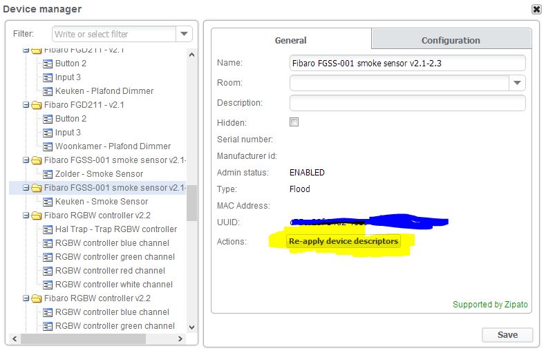

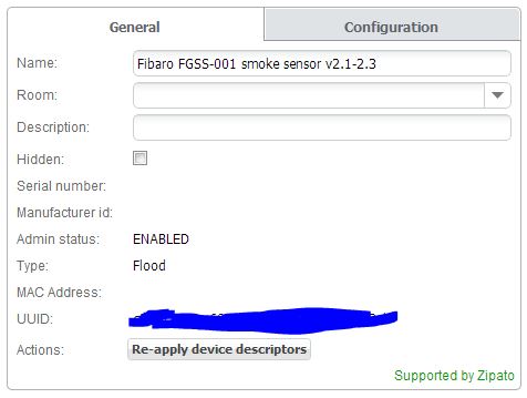

I watched the screenshot SmokeSensor2.jpg about setup the sensor. I have already it on my zipabox but I don't have this option. I must do something to have ? Synchronize, update ?
Tried to re-apply descriptors?
Thank you for your response. But how I can do it ? I need exlude the sensor and include it again ?
Just click on Total Devices in Gerneral part
Select your smoke sensor "folder"
Click on Configuration TAB
Click on the button as marked on the screenshot
Thank you for your help, but when I wrote the post I didn't have "re-apply device description".
I have exluded and included the sensor and now I could setup it after click on the button....

-Device is seen as "Generic Sensor Sensor" and device type is defined as "Flood". Would be nice to have that Fire Sensor icon
-Temperature meter has the meter icon and NOT the temperature icon.

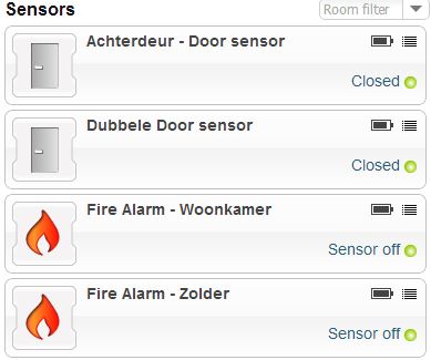

-By default Acoustic and Visual Alerts are set to "BOTH_INACTIVE" which means (correct me if i am wrong) that no siren or visual warning in case of a fire. I changed this to BOTH_ACTIVE off course.-Also i have enabled ALARM_BROADCAST so if 1 smoke sensor is triggered the other should also change to alarm state.Small test:Trigger Fire alarm using e-sigaret:-Smoke sensor blinks and siren sound OK. The sensor is NOT displayed as "sensor on" in the control center-Siren stops if you press button for 3 seconds (1 time press does not work) Visual alarm will not stop even after the 3 second press. You will need to remove battery and after you reinserted battery all is normal again.-ALARM_BROADCAST has been enabled but other sensor (with same setting) was NOT triggered-Tamper protection is working OK ; if device is removed from socket my Fibaro RGBW received they alarm and started a scene-Fire Alarm also triggers Fibaro RGBW module by setting to white 100%-I checked but no events are being logged/displayed regarding the triggering of the fire sensor (also not in live view). Only events are temperature related.
Zipato made some changes and the outcome is: ......
-The Smoke sensor is now displayed as a sensor-Device Type is "Fire" now-Sensor icon would be nice if it would have Fire Sensor icon thoughIf Device is changed to Fire Sensor the temperature meter is shown with Normal meter counter.
Tested Smoke sensors and triggered them by using e-sigarette:-Smoke sensor alarm is OK-Smoke Sensor in Control sensor stays on status "No smoke"-Broadcast to other sensors doesn't work-No events are logged regarding the smoke alarm (only temperature events)
