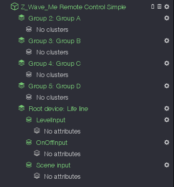

I bought a Popp KFOB-C 4 buttons keyfob ( http://www.popp.eu/products/controllers/kfob-remote-control/ ) It doesn't seem to be supported. I can include it but can't have access to buttons in rules. See in file included what I get when I include it.

Dear Philippe,
Could you give me some tips on how you have implemented your keyfob? I look strange to me not to have the possibility to modify parameters in the configuration tab. Did you use custom configuration?
I saw that the 4 groups are listed as controls in the rule manager but it doesn't seem that just pushing a button trigger successfully an event cacheable by a rule at least with the standard configuration.
I was thinking doing just a simple rule like "when button 1 is pushed, toggle light X" but I didn't succeed for the time being.
Any help is welcome ;-)

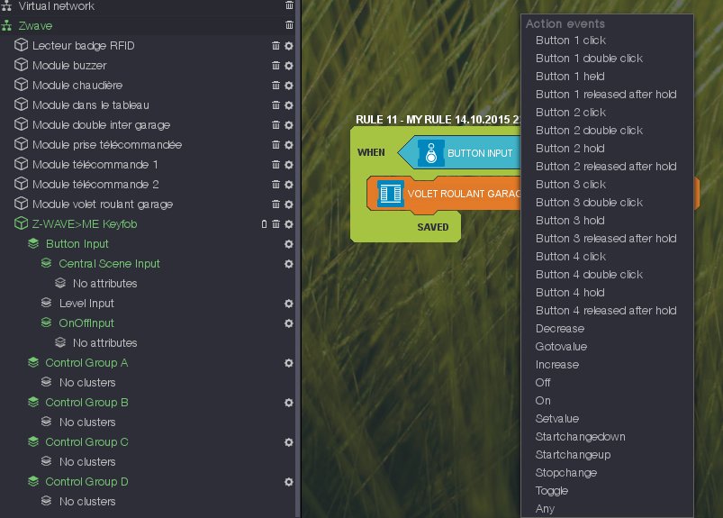

I have reset my keyfob and join it again. I get this (see attached picture). As you can see, I get a long list of events for use in rules. I didn't change anything in configuration. For each button, there is 4 events: click, double click, hold, release after hold. If you select "click", if you press button slowly, the rule is not triggered because it's an "hold" event. To avoid this, in my rules I have done an OR with "button click" and "hold".
Thanks. I was expecting 4 items, one for each button and not everything in the same list. I have indeed the same situation as you and I can start my testing this weekend.
