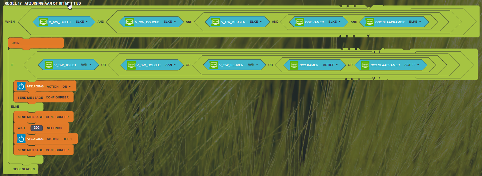

It is a similar scenario like when you have switches for the UFH and a separate switch for the boiler and you need to ensure that whenever the last switch also tells that it does not need heat, the boiler switch to be turned off. Right now I cannot do such rule, but here is what you need:
When block, inside the when block you will have as many "and" block as many switches and virtual sensors you have that can trigger the action (in your case 5 triggers so it will be 4 "and" puzzle), Each one will be in the when block as "any" change.
Then join block
Then If Else block. the if block will have 4x "Or" block and in each one you insert a sensor with "on" state (in total 5). Action will be to turn on the ventilation switch. Elas turn off.
This is it.
Then join block
This is it.
I have solved the problem bij making 3 viriual switches and 3 rules that makes the switch active an 3 that make them inactive when the coco switches are ativated or deactivated
these switches have i put i the rule instate of the coco switches.
and i put some email messages in the rule to monitor the rule for a while until i am confidence it works always
