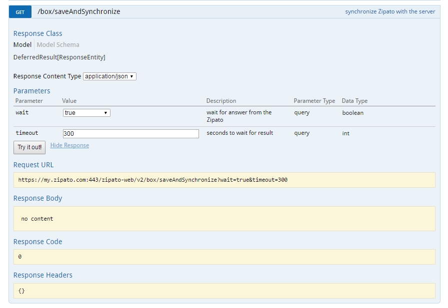

My Zipabox does not sync even from the API, also the response from the server is NULL, normally even if it fails it will give you a response.
