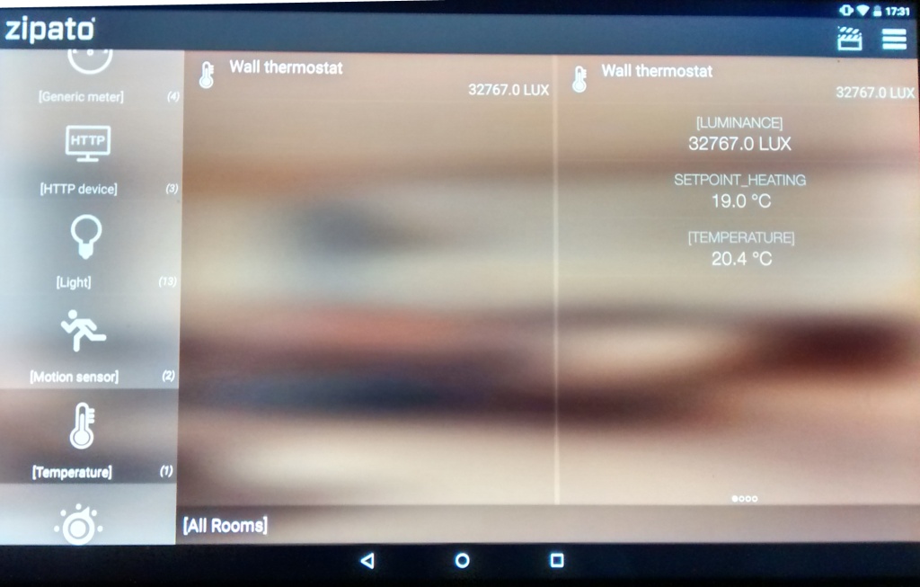

I have a Horstman thermostat HRT4-ZW.
When I use the Zipato app V3.1.4 on my tablet I see a LUMINANCE value in the list.
also the normal expected Setpoint and Themperature value when I go to the wall thermostat
(see image)
Where is that luminnance value comming from?
(I have also 2 multisensor but they do not have that large luminance value showing 22 lux and 123 lux now)

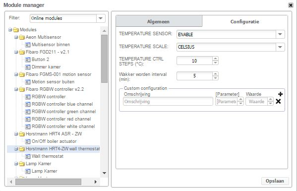

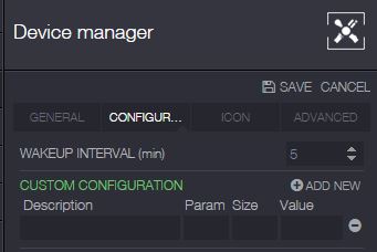

I have an open ticket to the support on this matter because I had also suddenly a LUMINANCE value attached to my HRT4-ZW. They have normally fixed the problem and they asked me to remove the device and to reinclude it. I am currently testing the result and I had yesterday problems in the association with the climate widget.
I suggest to keep as it is for time being and I will keep you posted when the problem is fully solved. However, I am interested to compare what are your available parameters in the configuration tab of your HRT4-ZW because I think that some are gone since I had to reinclude it (see picture).
I work with the old web version of zipato.
See files for the settings
(I asume that you know how to switch to the old web version)

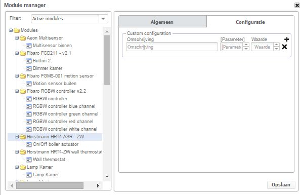

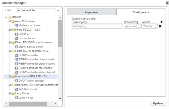

I paired the HRT4-ZW with the boilerswitch HRT_ASR outside the Zipato box.
Then added both to the zipatoBox and NO assosiation in the Zipato box (HRT.JPG)
