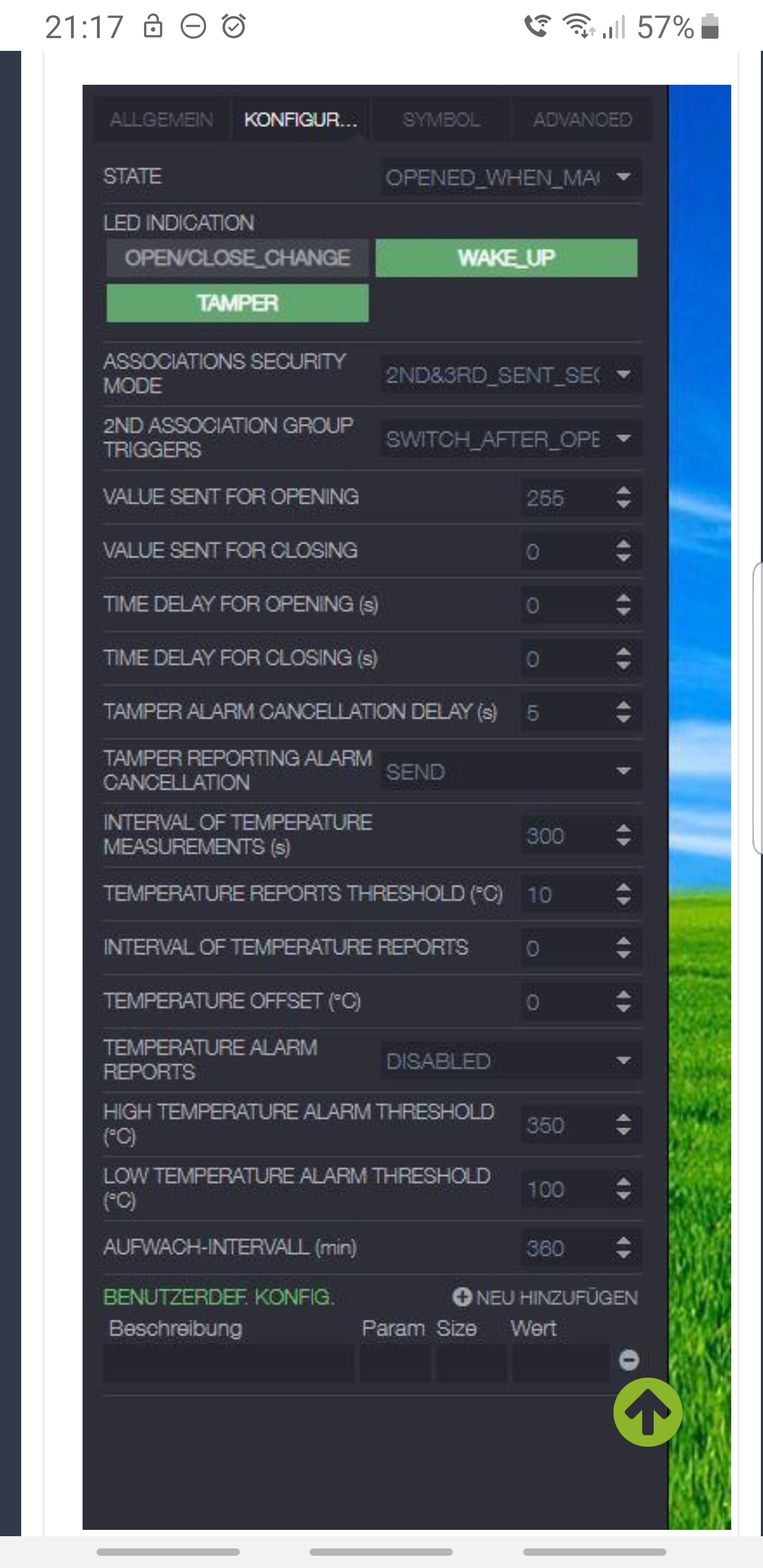

I have connected a Fibaro Door/Window FGDW-002 Zwave to the Zipabox 2. The open close sensor is working fine. But the Temperatur is still on 25.1 C. No change. I have delete it from System and connected it new. Same Problem. I have change in the configuration the point "Intervall of temperature reports" of 300. No change. My Fibaro Smoke detector displays the Temperatur correct. Is the sensor defect?

Ok, i have changed the sensor. The new one gave me the correct data of temperature
