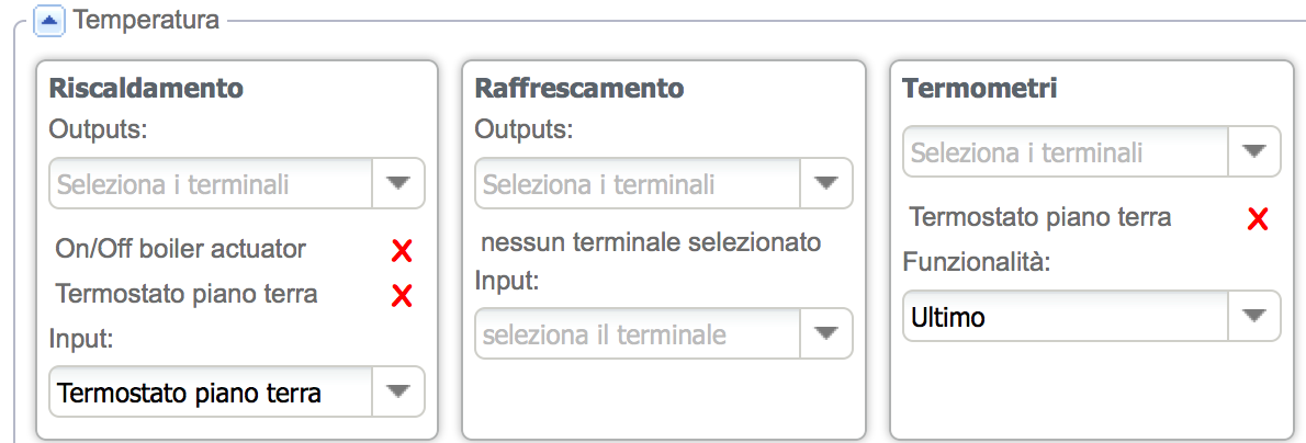

Hi all!
I've the same issue, the widget doesn't change the display of SRT321 and of course the boiler actuator doesnt behave correspondingly...
viceversa if I change the set point temperature with the wheel in the SRT321, the value is correctly reported on the thermostat widget.
I attach the screenshot of my thermostat.
Hi all!

so... let me understund... if in my widget I set a new desiderable temperature, this is not anymore transmitted to STR321, ok... but I suppose this becomes a new target for my system, so if it is grather than current temp, my on/off actuator should go to ON in order so reach the new target temperature set in the widget even if the set_temperature of STR321 is low. Why this is not appening?! maybe my climat widget is not ok? I tried to put as output only the thermosat (STR321) and in another attempt I set 2 outputs: thermostat and on/off boiler switch.
I've a floor heating and I set the SRT321 with TPI optimized for 6 "on" per hour.
If I use directly the wheel on SRT321 to set a desired temperature, the system start and at the end reach that temperature. perfect. (note: the temperature set, as I wrote in the last message, is reported also to the widget, that's means that everything is well associated...)
BUT
if for example I leave the temperature in the SRT321 to 18, and after in the widget I increase the target temp to 20, nothing special appens... the boiler switch just turns on regularly, 6 times per hour, just to mantain the set point in the SRT321 (18) which should instead be overlooked by the new value in the widget (20).
Please if you have any suggestion to solve my problem or at least to better understand how everything is working, let me know!!! TNX again
