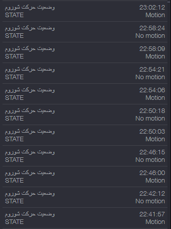

without the doubt zipaTOY is the worst zawve automation ....
theres stability problem everytime
this is just one example i share with u guys
** the system is armed and im not home but is motion there :)) theres 2 surmise
1- theres ghost in the house (f**ing bullS**t)
2-the zipaTOY side has a biG problem about stability
Replies (4)
Hello,Have you tried to adjust the sensitivity of the motion detector?
"Zipatoy" has problems but not at this stage. I think it's a problem of tuning ... Which of your sensors is experiencing this problem?

Your problems are not related to Zipato. Your sensors are sending MOTION message to your Zipato controller and Zipato controller is only doing what is it programed for. You obviously don't know much about Z-wave and home automation in general, so I suggest you should ask for some professional help.

Have to agree with Sebastian on this one, the COntroller is only receiving the message from the sensor, it is the sensor that is perhaps sending faulty messages. What brand and model sensor is it?
IR sensors can send a state change with a fluctuation in air temp to, so dont mount them near AIR units.
We had a motion sensor going off on a zipatile until we worked out it was flies setting it off. The heat from the Zipatile was attracting flies to the Zipatile and when they walked over the sensor it was setting it off. So you can see there can be many different reasons, but mainly it is the sensors fault not the controller.

which sensors and switches? what brands are they?
