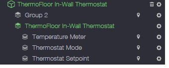

I have successfully included this thermostat with my Zipabox, however, it seems like it is only possible to read from the thermostat, and not write to it. I want to set the setpoint from Zipabox, and create rules. What am I doing wrong?

Hello Again, I have found out that I can write to the thermostat by setting parameters in Zipato. But I want to be able to write to the thermostat from the mobile app and gui in web interface. How can I make parameters available there?

Hi, I just got these installed in my house yesterday.
Here is how to make use of them:
- Pair the z-wave as usual.
- Create a virtual thermostat with the following settings:
- - HEATING -> OUTPUT -> Select your Thermofloor In-Wall Thermostat.
- - HEATING -> INPUT -> Select your Thermofloor In-Wall Thermostat.
- - THERMOMETERS -> INPUT -> Select your Thermofloor In-Wall Thermostat.
- - THERMOMETERS -> FUNCTION -> Last
- - Save
It might take a couple of minutes until you get a proper temperature reading from the thermostat, just give it a few minutes.
You should be able to set the setpoint for heating straight away.
