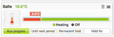

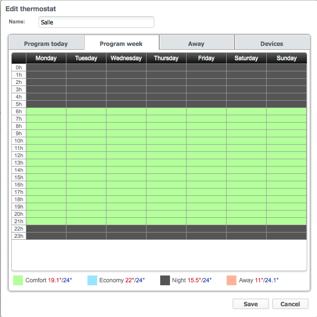

It's not possible. Each time I do something it breaks. This time, I define away period and then I noticed I didn't change the temperature. Then I change the temperature to 11° and the temperature is the dashboard is not 11°

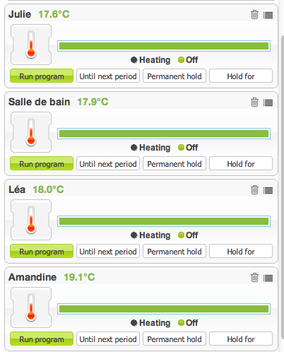

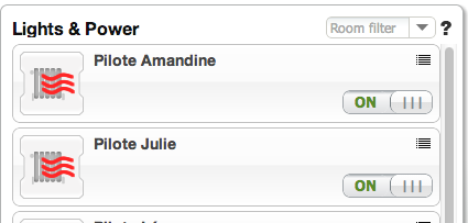

another issue. all thermostat are off and I have heating system on and they were off some time ago. Thank you zipato. With the system instead of saving some money I spend even more !!

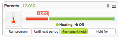

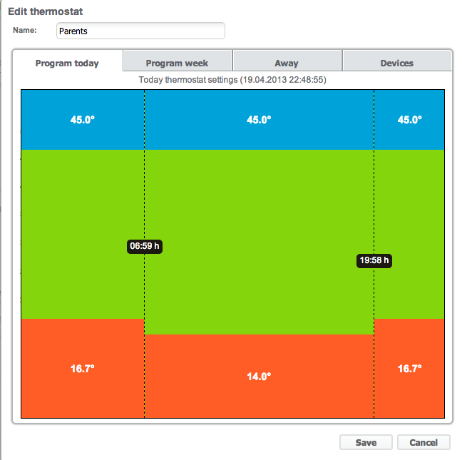

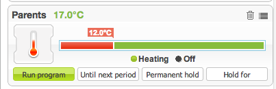

another issue. I have 1 thermstat in permanently hold and when I put it back in program the requested temperature doesn't change. See attached.

The problem was that in some cases the thermostat wouldn't actually start controlling the actuators after Zipabox reboot until the temperature was manually adjusted.
It happened
We've updated your box with fixed firmware. I hope you will be able to save some energy with this one...
It happened
ah thanks for that. Indeed what you describe seems to be some of my issues. Not sure it addresses everything but let's work step by step. I'll report new issue.

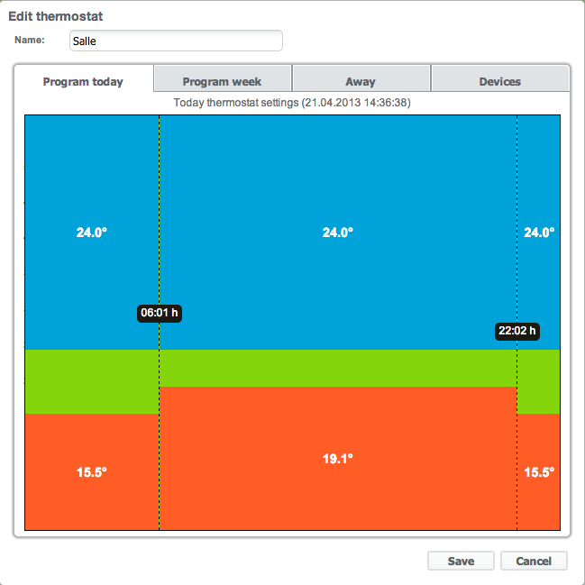

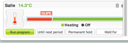

Still an issue. I put back the thermostat form permanently hold to run program and the temperature doesn't change.
yes but the temperature was neither the away temperature or the program :)
