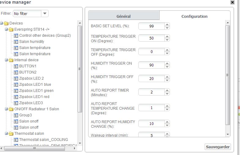

I have the same problem with a Everspring ST814 -/+
I set-up a room but it does not want to save it.
I clicked on the new module in general panel and then on the module, I selected a room and clicked on save
I found why, it is because the default value in the configuration tab of the st814 where rejected by the GUI. For example the GUI requied to have a TEMPERATURE TRIGGER ON less than 50 or by default it is 99. When I clicked on save, the GUI displayed these fields in red but because the current tab was "General" and no pop-up displayed I did not understand that was a problem on "configuration" tab. It could be nice to improve the information: may be a pop-up or to avoid a pop-up (that is not the idea of your GUI you could underline in red the tab ? What do you think?
Thank you Fred for finding and submitting that problem.
It will be fixed asap.
