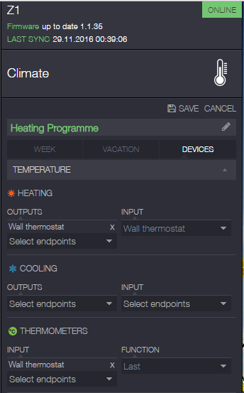

Could you please provide a screenshot of climate configuration, especially the devices tab

I think it's an issue with your climate configuration.

Please see the picture attached for the climate configuration. Basically, I have the Horstmann Thermostat set as output, input and the thermometer. I have joined the boiler receiver directly with the Thermostat.

This is possible as you have selected the output to be the thermostat and not the actuator. What it does is that you set a new temperature on the dial. It goes to virtual thermostat. This then sends back the same information to the thermostat. Now immediately when the next program change happens it sends this to the thermostat and your manual change on the dialler is overwritten right after the thermostat wakes up.
This is why I said, remove the thermostat as output and add the actuator as output.
