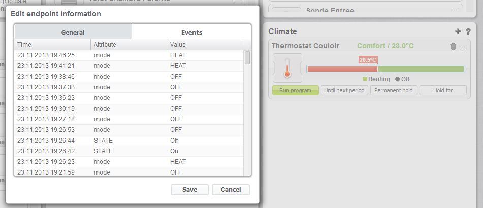

I have a problem with my climate widget ... I really don't understand why one is heating and the other not ?!
yUbr6e0VIUoxjTS5nVDL
Can you explain me why with the same rule and same temperature the order is different ?
Imossible to put the parameters that I want my widget don't want to save it :-(
pGnSLZvES7MGvgeGO4gO
It doesn't want to register the temperature to 19,7
37ro5dh9utfKR6OM7lp9
I become crazy with this widget ! please help me !

Similar issues with 0.9.999.2a firmware.
Sometimes the climate zone does not turn OFF the heater even when the measured temparature is more than 1 degree above the temperature I have set for the period.
Because we have no control on the Histeresis value, we do not know if it is linked to hysteresis or not...
I opened a ticket for the climate issue (Climate not turning on/off heater controlled by a FIBARO FGS221). Zipato team was very responsive on the ticket. support team said they captures log and that development is working on the problem.
The problem is apparently not solved with firmware 0.9.999.3
When temperature drops below the requested temperature, the actuator does not always turn on (Fibaro FGS221)...
Sad, the problem seems to have no solution.
Will go back to older methods for controlling heating, otherwise we will catch a cold!
