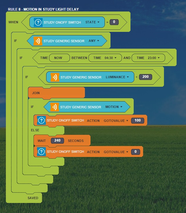

that sounds good. So the rule will only trigger when the switch is off. So in puzzle, my example is a dimmer, so the state is less than 1 or equal to 0. If it is an on/off switch, you can just use a sensor block with the actuator as off.
