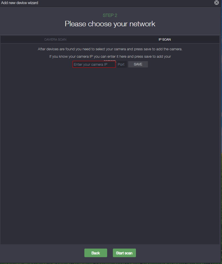

you need to setup the foscam camera to "working state", which means activate the camera (if needed) and make it able to stream content via RTSP.
If you are able to open RTSP link from the camera on example VLC or whatever other app then you are able to use it on Zipato.
After that go to the Zipato UI or mobile app and add the camera using the manual scan:
After you add the camera enter the username + password + RTSP URL that works for you (and snapshot eventually) usually its rtsp://cameraIP/path
After that it should work in your mobile phone app and or webUI (on my.zipato web works only, on my3.zipato it works only via our NEW app).
